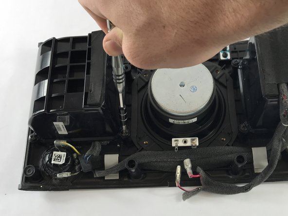

  7. Sonos Play 5 Mid- Range Speakers Replacement, Mid- Range Speakers: crwdns2935265:07crwdnd2935265:01crwdnd2935265:02crwdne2935265:0 Sonos Play 5 Mid- Range Speakers Replacement, Mid- Range Speakers: crwdns2935265:07crwdnd2935265:02crwdnd2935265:02crwdne2935265:0
    • Remove four 9.5mm Phillips #2 screws.
  8. Sonos Play 5 Mid- Range Speakers Replacement: crwdns2935265:08crwdnd2935265:01crwdnd2935265:01crwdne2935265:0
  9. Sonos Play 5 Mid- Range Speakers Replacement: crwdns2935265:09crwdnd2935265:01crwdnd2935265:02crwdne2935265:0 Sonos Play 5 Mid- Range Speakers Replacement: crwdns2935265:09crwdnd2935265:02crwdnd2935265:02crwdne2935265:0
    • Unplug the wires connected to the left speaker.
  10. Sonos Play 5 Mid- Range Speakers Replacement: crwdns2935265:010crwdnd2935265:01crwdnd2935265:01crwdne2935265:0
    • Pull the left speaker up and away from the front panel.

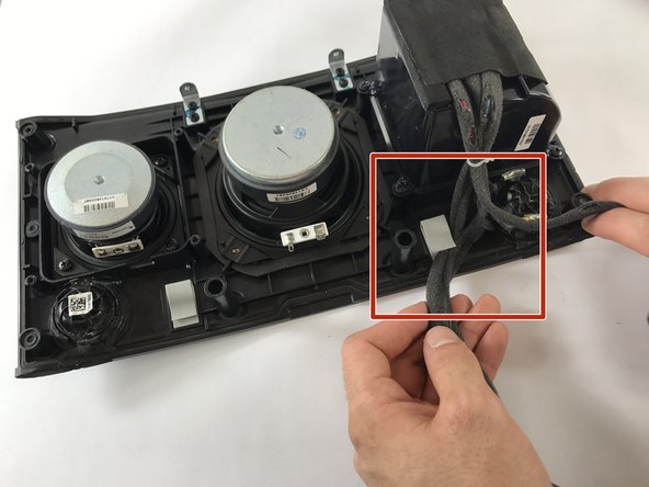

  11. Sonos Play 5 Mid- Range Speakers Replacement: crwdns2935265:011crwdnd2935265:01crwdnd2935265:02crwdne2935265:0 Sonos Play 5 Mid- Range Speakers Replacement: crwdns2935265:011crwdnd2935265:02crwdnd2935265:02crwdne2935265:0
    • Remove the wires from the plastic clips on the bottom of the front panel.
  12. Sonos Play 5 Mid- Range Speakers Replacement: crwdns2935265:012crwdnd2935265:01crwdnd2935265:01crwdne2935265:0
  13. Sonos Play 5 Mid- Range Speakers Replacement: crwdns2935265:013crwdnd2935265:01crwdnd2935265:01crwdne2935265:0
    • Remove the plastic speaker cover by lifting up and away.
  14. Sonos Play 5 Mid- Range Speakers Replacement: crwdns2935265:014crwdnd2935265:01crwdnd2935265:01crwdne2935265:0
  15. Sonos Play 5 Mid- Range Speakers Replacement: crwdns2935265:015crwdnd2935265:01crwdnd2935265:01crwdne2935265:0
    • Remove the right mid-range speaker buy pulling up and away from the front panel.
