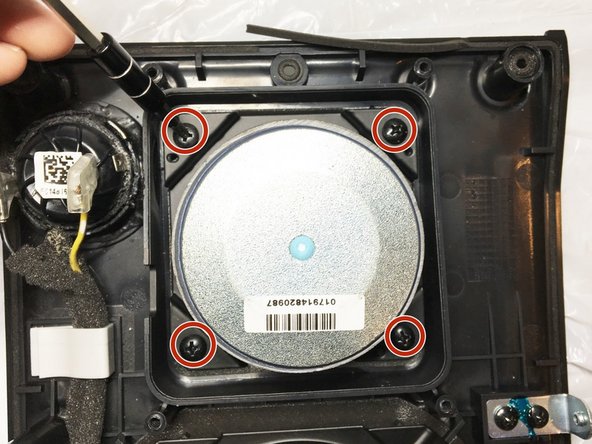

  8. Sonos Play 5 Mid Range Driver Replacement, Mid Range Driver: crwdns2935265:08crwdnd2935265:01crwdnd2935265:02crwdne2935265:0 Sonos Play 5 Mid Range Driver Replacement, Mid Range Driver: crwdns2935265:08crwdnd2935265:02crwdnd2935265:02crwdne2935265:0
    • Use a #1 Philips-head screwdriver to remove the 12mm screws
    • The speaker contains two Mid-Range Drivers located on either side of the bass speaker, we are replacing the speaker on the right-hand side .

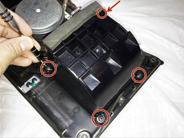

  9. Sonos Play 5 Mid Range Driver Replacement: crwdns2935265:09crwdnd2935265:01crwdnd2935265:02crwdne2935265:0 Sonos Play 5 Mid Range Driver Replacement: crwdns2935265:09crwdnd2935265:02crwdnd2935265:02crwdne2935265:0
    • With your thumb and forefinger, remove the two female wiring connectors. Grip with moderate force while wiggling the connector outward.
    • Remove the four remaining 10mm screws with a #1 Philips-head screwdriver.
    • These screws are coated with glue on the inside and require more force to unscrew.

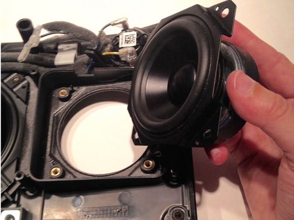

  10. Sonos Play 5 Mid Range Driver Replacement: crwdns2935265:010crwdnd2935265:01crwdnd2935265:02crwdne2935265:0 Sonos Play 5 Mid Range Driver Replacement: crwdns2935265:010crwdnd2935265:02crwdnd2935265:02crwdne2935265:0
    • Remove the Mid-Range Driver from it's seat by grasping the back-end and pulling upward, away from the speaker housing.
