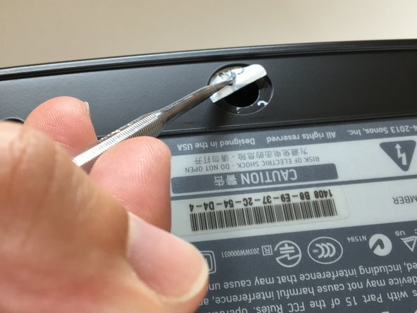

  2. Sonos Play 5 Bass Speaker Replacement: crwdns2935265:02crwdnd2935265:01crwdnd2935265:03crwdne2935265:0 Sonos Play 5 Bass Speaker Replacement: crwdns2935265:02crwdnd2935265:02crwdnd2935265:03crwdne2935265:0 Sonos Play 5 Bass Speaker Replacement: crwdns2935265:02crwdnd2935265:03crwdnd2935265:03crwdne2935265:0
    • Use a pointed metal spudger to remove the rubber plugs covering the screws in the bottom left and right corners of the speaker panel.
    • Insert the spudger against the side of the rubber plug and the speaker panel while leveraging upward.
    • Remove the eight 12 mm Phillips #1 screws bordering the front speaker panel.

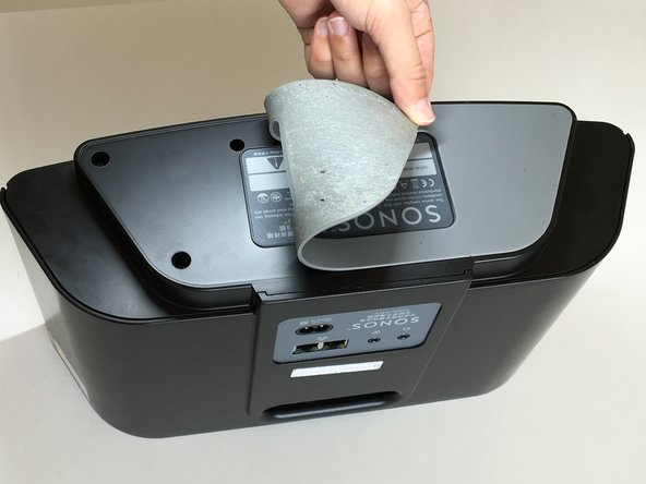

  3. Sonos Play 5 Bass Speaker Replacement: crwdns2935265:03crwdnd2935265:01crwdnd2935265:02crwdne2935265:0 Sonos Play 5 Bass Speaker Replacement: crwdns2935265:03crwdnd2935265:02crwdnd2935265:02crwdne2935265:0
    • Orient the speaker so that the volume and speaker control buttons are facing down onto your work space. The Sonos name and product number should be facing upward toward the ceiling
    • Use a metal spudger to pry the outer corner of the grey rubber pad revealing eight 12mm screws.

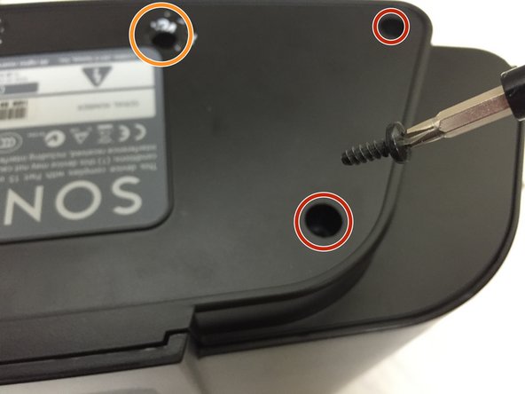

  4. Sonos Play 5 Bass Speaker Replacement: crwdns2935265:04crwdnd2935265:01crwdnd2935265:03crwdne2935265:0 Sonos Play 5 Bass Speaker Replacement: crwdns2935265:04crwdnd2935265:02crwdnd2935265:03crwdne2935265:0 Sonos Play 5 Bass Speaker Replacement: crwdns2935265:04crwdnd2935265:03crwdnd2935265:03crwdne2935265:0
    • With a #1 Phillips-head screwdriver, remove the eight 12mm screws on the bottom panel.
    • We have marked the original placement of the warranty stickers in orange. To remove use a pair of tweezers to grip onto the sticker and pull with a gentle upward motion
    • We have already removed the warranty stickers in this picture.

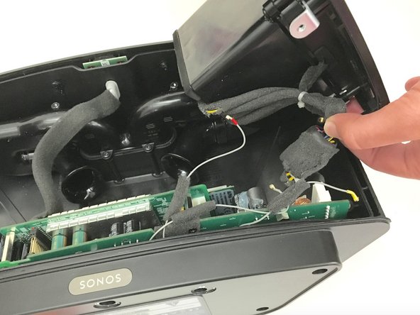

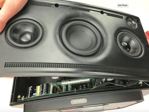

  6. Sonos Play 5 Bass Speaker Replacement: crwdns2935265:06crwdnd2935265:01crwdnd2935265:03crwdne2935265:0 Sonos Play 5 Bass Speaker Replacement: crwdns2935265:06crwdnd2935265:02crwdnd2935265:03crwdne2935265:0 Sonos Play 5 Bass Speaker Replacement: crwdns2935265:06crwdnd2935265:03crwdnd2935265:03crwdne2935265:0
    • Use both hands to lift the front speaker panel away from the skeleton of the speaker housing.
    • While removing the front speaker panel, pay close attention to the bottom right-hand corner. There will be an antenna connector you will need to remove in the next step.

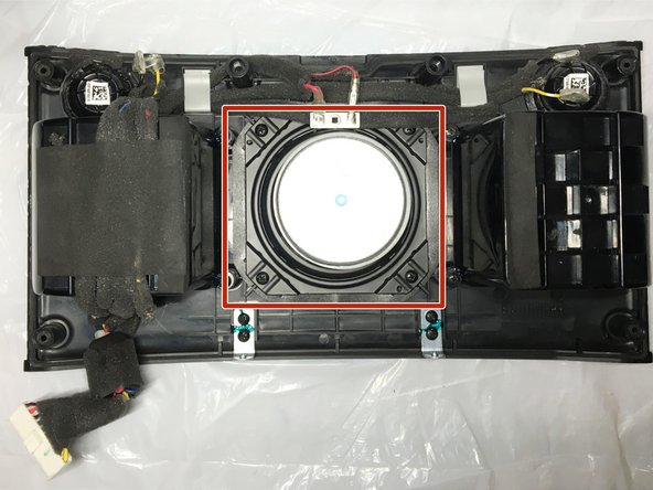

  8. Sonos Play 5 Bass Speaker Replacement, Sonos Play 5 Bass Speaker: crwdns2935265:08crwdnd2935265:01crwdnd2935265:02crwdne2935265:0 Sonos Play 5 Bass Speaker Replacement, Sonos Play 5 Bass Speaker: crwdns2935265:08crwdnd2935265:02crwdnd2935265:02crwdne2935265:0
    • The bass is located in the middle of the two mid-range driver speakers
    • Point of reference: This picture illustrates the back-side of the speaker panel.

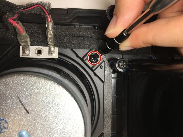

  9. Sonos Play 5 Bass Speaker Replacement: crwdns2935265:09crwdnd2935265:01crwdnd2935265:02crwdne2935265:0 Sonos Play 5 Bass Speaker Replacement: crwdns2935265:09crwdnd2935265:02crwdnd2935265:02crwdne2935265:0
    • Use a Philips screwdriver bit-size #1 to remove the four 10mm screws surrounding the bass.

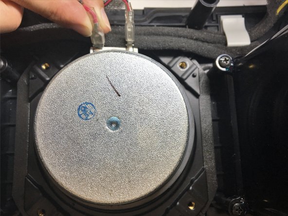

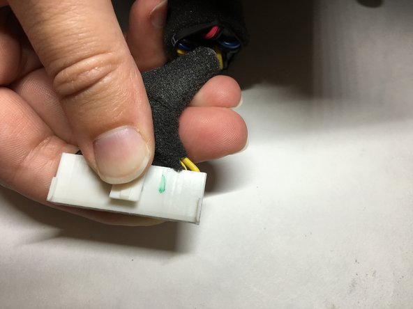

  10. Sonos Play 5 Bass Speaker Replacement: crwdns2935265:010crwdnd2935265:01crwdnd2935265:02crwdne2935265:0 Sonos Play 5 Bass Speaker Replacement: crwdns2935265:010crwdnd2935265:02crwdnd2935265:02crwdne2935265:0
    • Disconnect the two spade connectors from the tabs on the speaker.

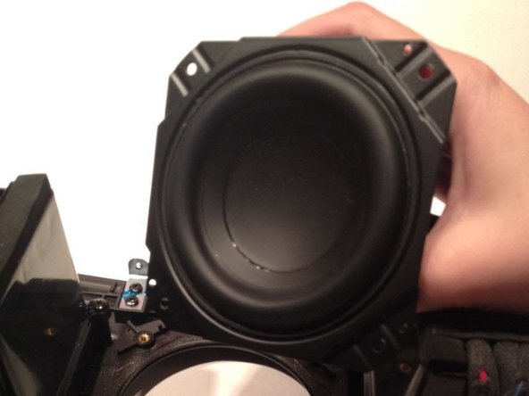

  11. Sonos Play 5 Bass Speaker Replacement: crwdns2935265:011crwdnd2935265:01crwdnd2935265:02crwdne2935265:0 Sonos Play 5 Bass Speaker Replacement: crwdns2935265:011crwdnd2935265:02crwdnd2935265:02crwdne2935265:0
    • Remove the bass speaker from its seat by grasping the back-end and pulling upward.
