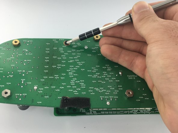

  15. Sonos Play 5 Audio/Control Board Replacement: crwdns2935265:015crwdnd2935265:01crwdnd2935265:02crwdne2935265:0 Sonos Play 5 Audio/Control Board Replacement: crwdns2935265:015crwdnd2935265:02crwdnd2935265:02crwdne2935265:0
    • Unscrew Four Phillips #2 bolts
    • These bolts will not come out, but will pull out of the nuts on the other side of the board
