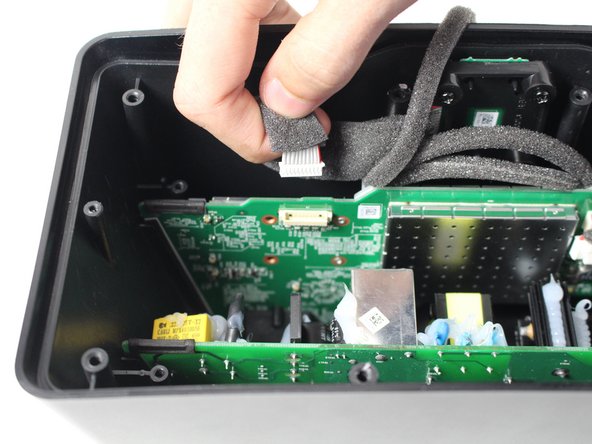

    • Disconnect the front panel from the motherboard by gently reaching in and pushing the tab underneath the wire connector and pulling towards you.

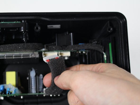

    • Disconnect the motherboard from the power supply board by gently reaching in and pushing the tab underneath the wire connector and pulling towards you.
  8. Sonos Play 3 Wireless Card Replacement: crwdns2935265:08crwdnd2935265:01crwdnd2935265:02crwdne2935265:0 Sonos Play 3 Wireless Card Replacement: crwdns2935265:08crwdnd2935265:02crwdnd2935265:02crwdne2935265:0
    • Disconnect the motherboard from the volume button board by gently grabbing the connector and pulling it towards you.

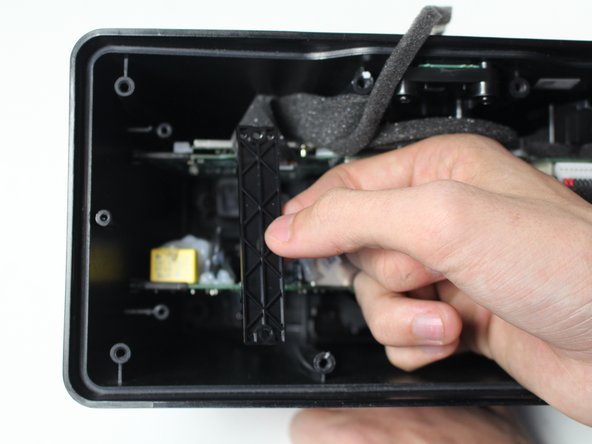

  9. Sonos Play 3 Wireless Card Replacement: crwdns2935265:09crwdnd2935265:01crwdnd2935265:01crwdne2935265:0
    • Using a Phillips #2 screwdriver, remove the 4 screws securing the two plastic panels down.
  10. Sonos Play 3 Wireless Card Replacement: crwdns2935265:010crwdnd2935265:01crwdnd2935265:02crwdne2935265:0 Sonos Play 3 Wireless Card Replacement: crwdns2935265:010crwdnd2935265:02crwdnd2935265:02crwdne2935265:0
    • Remove the two plastic panels on either side of the device that hold the motherboard and power supply board in place.

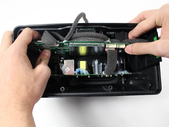

  12. Sonos Play 3 Wireless Card Replacement: crwdns2935265:012crwdnd2935265:01crwdnd2935265:03crwdne2935265:0 Sonos Play 3 Wireless Card Replacement: crwdns2935265:012crwdnd2935265:02crwdnd2935265:03crwdne2935265:0 Sonos Play 3 Wireless Card Replacement: crwdns2935265:012crwdnd2935265:03crwdnd2935265:03crwdne2935265:0
    • Gently remove the motherboard from the Sonos device by sliding it straight back towards you.
    • When putting the motherboard back inside the device, make sure it slides in the slots smoothly on both sides.

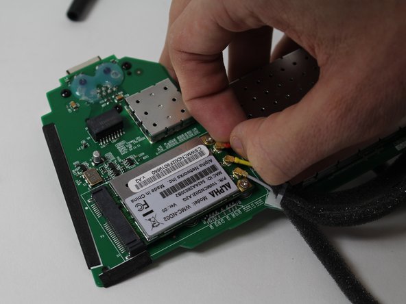

  13. Sonos Play 3 Wireless Card Replacement, Wireless Card: crwdns2935265:013crwdnd2935265:01crwdnd2935265:01crwdne2935265:0
    • Before accessing the wire connectors, there will be glue covering all three of them and the screws. Remove this first carefully.
    • Using a Phillips screwdriver, unscrew the two screws securing the communication card to the motherboard.

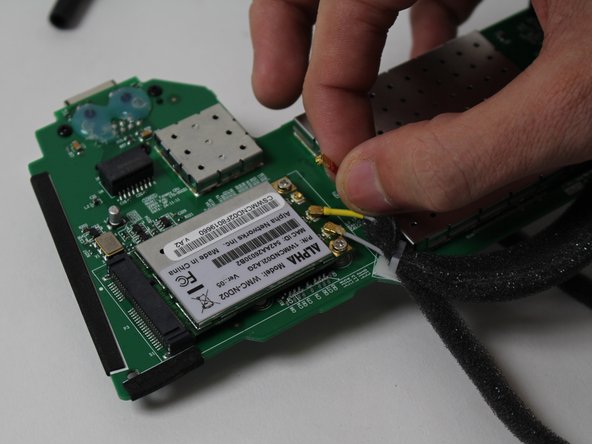

  14. Sonos Play 3 Wireless Card Replacement: crwdns2935265:014crwdnd2935265:01crwdnd2935265:03crwdne2935265:0 Sonos Play 3 Wireless Card Replacement: crwdns2935265:014crwdnd2935265:02crwdnd2935265:03crwdne2935265:0 Sonos Play 3 Wireless Card Replacement: crwdns2935265:014crwdnd2935265:03crwdnd2935265:03crwdne2935265:0
    • Disconnect the wire connector clips from the communication card by just using your index finger and thumb.

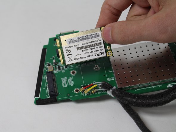

  15. Sonos Play 3 Wireless Card Replacement: crwdns2935265:015crwdnd2935265:01crwdnd2935265:02crwdne2935265:0 Sonos Play 3 Wireless Card Replacement: crwdns2935265:015crwdnd2935265:02crwdnd2935265:02crwdne2935265:0
    • Remove the communication card by grabbing it with your index finger and thumb and pulling it to the right and up.

Do you have a recommendation for a replacement wireless card? If so where can I purchase it?
Max Chadwick - crwdns2934203:0crwdne2934203:0
Maybe it's too late...I have fund this card, which works perfectly on my play:3
Atheros AR5BXB112 AR9380 card Dual-Band 802.11N PCI-E 450M link for Mac Pro wifi card PPD-AR5BXB112
Becco - crwdns2934203:0crwdne2934203:0
Is this the name for the card, could you please send a link?
Blue Parrot -
This post really helped me reviving my Play:3 that suddenly stopped connecting to WIFI after more than 10 years of constant use. Just search on Becco's description and you will receive a 10 USD replacement piece installed within half an hour, instead of buying a new appliance for 40-times that amount. Always prefer mending over buying ;-)
