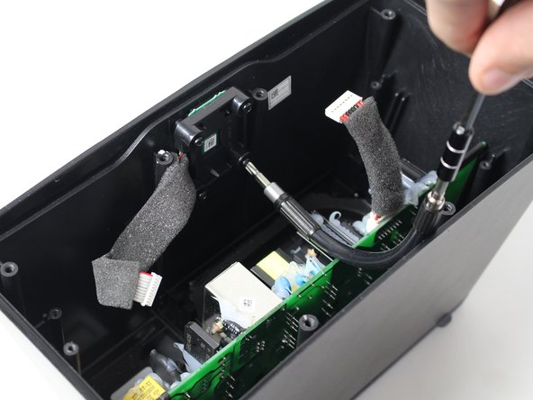

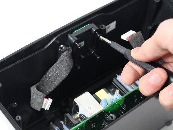

  13. Sonos Play 3 Volume Button Board Replacement, Volume Button Board: crwdns2935265:013crwdnd2935265:01crwdnd2935265:03crwdne2935265:0 Sonos Play 3 Volume Button Board Replacement, Volume Button Board: crwdns2935265:013crwdnd2935265:02crwdnd2935265:03crwdne2935265:0 Sonos Play 3 Volume Button Board Replacement, Volume Button Board: crwdns2935265:013crwdnd2935265:03crwdnd2935265:03crwdne2935265:0
    • Remove the four screws securing the button board to the case.
    • You may need a special screwdriver to remove the bottom two screws. We used the flexible shaft attachment from our iFixit 54 Bit Driver Kit

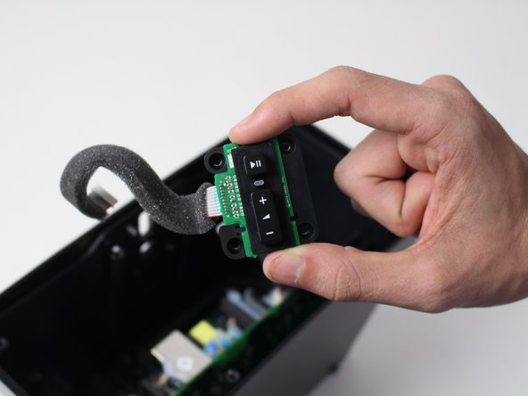

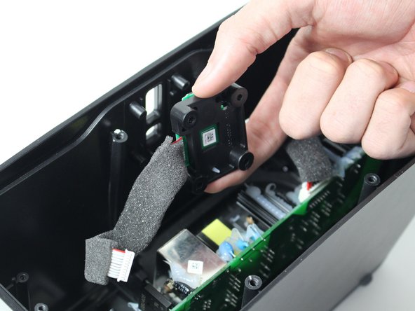

  14. Sonos Play 3 Volume Button Board Replacement: crwdns2935265:014crwdnd2935265:01crwdnd2935265:03crwdne2935265:0 Sonos Play 3 Volume Button Board Replacement: crwdns2935265:014crwdnd2935265:02crwdnd2935265:03crwdne2935265:0 Sonos Play 3 Volume Button Board Replacement: crwdns2935265:014crwdnd2935265:03crwdnd2935265:03crwdne2935265:0
    • Gently pull the button board toward you and then remove from the case.
