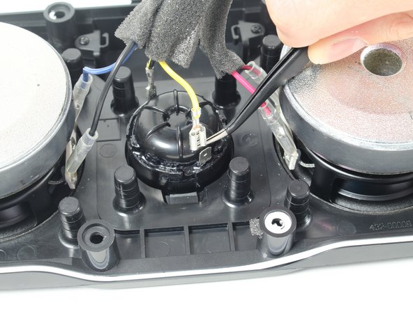

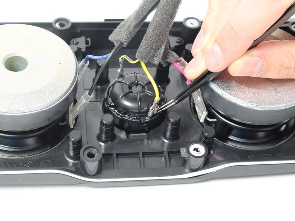

  7. Sonos Play 3 Tweeter Speaker Replacement, Tweeter Speaker: crwdns2935265:07crwdnd2935265:01crwdnd2935265:03crwdne2935265:0 Sonos Play 3 Tweeter Speaker Replacement, Tweeter Speaker: crwdns2935265:07crwdnd2935265:02crwdnd2935265:03crwdne2935265:0 Sonos Play 3 Tweeter Speaker Replacement, Tweeter Speaker: crwdns2935265:07crwdnd2935265:03crwdnd2935265:03crwdne2935265:0
    • Use tweezers to disconnect the wire connectors from the tweeter speaker. The connectors may be very tight, but we promise they do come off.
