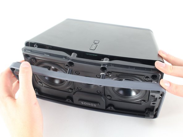

    • Remove the front panel carefully.
    • Note that there are two layers to the panel that should stay in their original order.

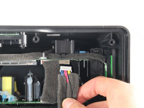

    • Disconnect the front panel from the motherboard by gently reaching in and pushing the tab underneath the wire connector and pulling towards you.

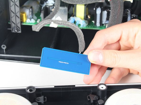

    • Gently remove the wireless card located at the bottom of the front speaker panel by pulling up and out with your index finger and thumb.

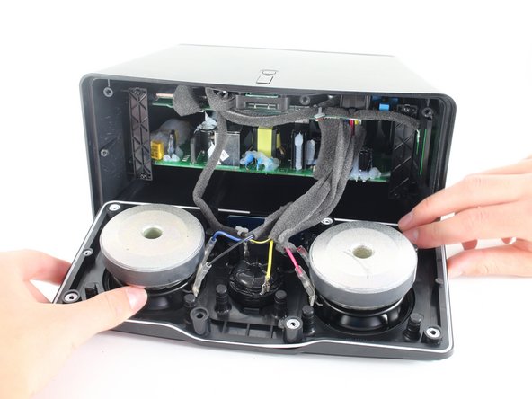

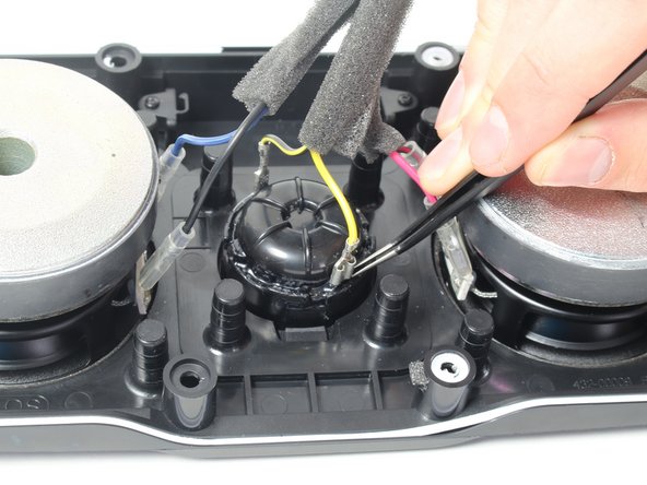

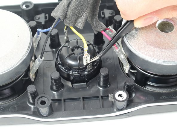

    • Use tweezers to disconnect the wire connectors from the mid-range speakers. The connectors may be very tight, but we promise they do come off.

    • Carefully lift the speaker you need to replace out the front of the panel.
