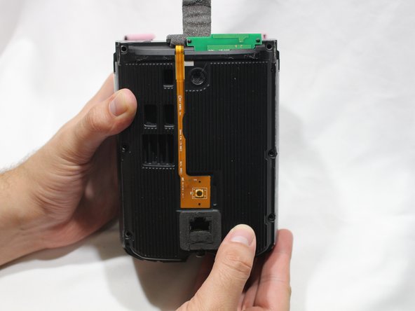

  6. Sonos One Tweeter Diaphragm Repair/ Replacement, Control Panel & Microphone: crwdns2935265:06crwdnd2935265:01crwdnd2935265:03crwdne2935265:0 Sonos One Tweeter Diaphragm Repair/ Replacement, Control Panel & Microphone: crwdns2935265:06crwdnd2935265:02crwdnd2935265:03crwdne2935265:0 Sonos One Tweeter Diaphragm Repair/ Replacement, Control Panel & Microphone: crwdns2935265:06crwdnd2935265:03crwdnd2935265:03crwdne2935265:0
    • Use the pointed end of a spudger to remove the covers that hide the screws.
    • Remove the four 9mm Torx T8 screws from around the perimeter of the control panel.
  7. Sonos One Tweeter Diaphragm Repair/ Replacement: crwdns2935265:07crwdnd2935265:01crwdnd2935265:02crwdne2935265:0 Sonos One Tweeter Diaphragm Repair/ Replacement: crwdns2935265:07crwdnd2935265:02crwdnd2935265:02crwdne2935265:0

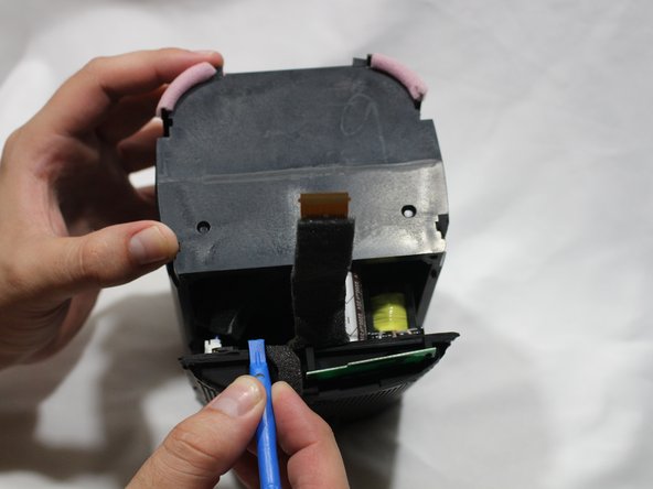

    • With the front of the unit facing you, lift the control panel up using your thumbs.
    • There's a ribbon cable attaching the control panel to the speaker so work slowly.
  8. Sonos One Tweeter Diaphragm Repair/ Replacement: crwdns2935265:08crwdnd2935265:01crwdnd2935265:03crwdne2935265:0 Sonos One Tweeter Diaphragm Repair/ Replacement: crwdns2935265:08crwdnd2935265:02crwdnd2935265:03crwdne2935265:0 Sonos One Tweeter Diaphragm Repair/ Replacement: crwdns2935265:08crwdnd2935265:03crwdnd2935265:03crwdne2935265:0
    • Use a spudger to flip up the retaining flap on the control panel ribbon cable ZIF socket.
    • Pull the control panel ribbon cable out of its socket.
  9. Sonos One Tweeter Diaphragm Repair/ Replacement: crwdns2935265:09crwdnd2935265:01crwdnd2935265:02crwdne2935265:0 Sonos One Tweeter Diaphragm Repair/ Replacement: crwdns2935265:09crwdnd2935265:02crwdnd2935265:02crwdne2935265:0
    • Pull the control panel away from the speaker to separate.

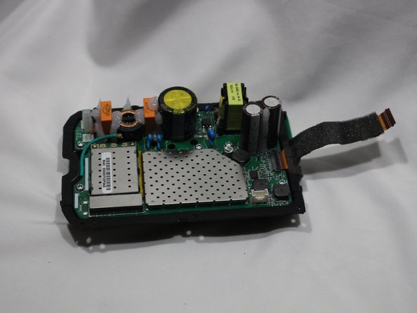

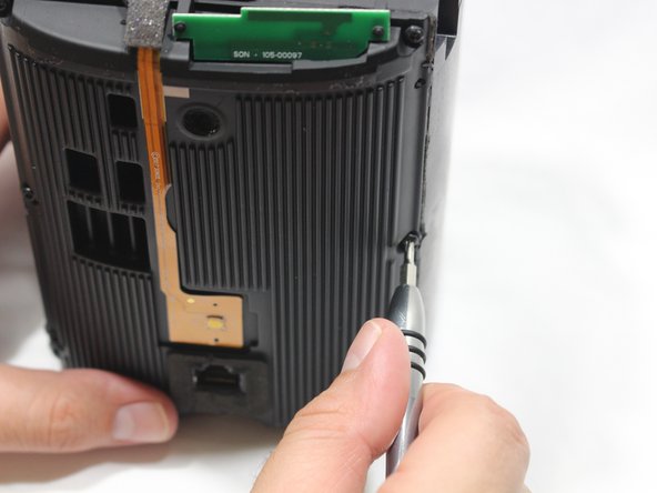

  10. Sonos One Tweeter Diaphragm Repair/ Replacement, Power Adapter Receptacle: crwdns2935265:010crwdnd2935265:01crwdnd2935265:03crwdne2935265:0 Sonos One Tweeter Diaphragm Repair/ Replacement, Power Adapter Receptacle: crwdns2935265:010crwdnd2935265:02crwdnd2935265:03crwdne2935265:0 Sonos One Tweeter Diaphragm Repair/ Replacement, Power Adapter Receptacle: crwdns2935265:010crwdnd2935265:03crwdnd2935265:03crwdne2935265:0

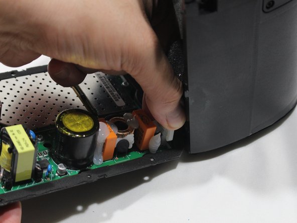

    • Remove the six 9mm Torx T8 screws from the motherboard panel.
  11. Sonos One Tweeter Diaphragm Repair/ Replacement: crwdns2935265:011crwdnd2935265:01crwdnd2935265:02crwdne2935265:0 Sonos One Tweeter Diaphragm Repair/ Replacement: crwdns2935265:011crwdnd2935265:02crwdnd2935265:02crwdne2935265:0
    • Using a plastic opening tool, separate the motherboard from the speaker.
  12. Sonos One Tweeter Diaphragm Repair/ Replacement: crwdns2935265:012crwdnd2935265:01crwdnd2935265:03crwdne2935265:0 Sonos One Tweeter Diaphragm Repair/ Replacement: crwdns2935265:012crwdnd2935265:02crwdnd2935265:03crwdne2935265:0 Sonos One Tweeter Diaphragm Repair/ Replacement: crwdns2935265:012crwdnd2935265:03crwdnd2935265:03crwdne2935265:0
    • Using your thumb, disconnect the speaker cable from the motherboard.
  13. Sonos One Tweeter Diaphragm Repair/ Replacement: crwdns2935265:013crwdnd2935265:01crwdnd2935265:03crwdne2935265:0 Sonos One Tweeter Diaphragm Repair/ Replacement: crwdns2935265:013crwdnd2935265:02crwdnd2935265:03crwdne2935265:0 Sonos One Tweeter Diaphragm Repair/ Replacement: crwdns2935265:013crwdnd2935265:03crwdnd2935265:03crwdne2935265:0
    • Disconnect the power adapter plug from the motherboard using your thumb.

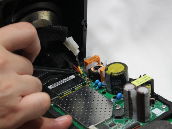

  14. Sonos One Tweeter Diaphragm Repair/ Replacement: crwdns2935265:014crwdnd2935265:01crwdnd2935265:03crwdne2935265:0 Sonos One Tweeter Diaphragm Repair/ Replacement: crwdns2935265:014crwdnd2935265:02crwdnd2935265:03crwdne2935265:0 Sonos One Tweeter Diaphragm Repair/ Replacement: crwdns2935265:014crwdnd2935265:03crwdnd2935265:03crwdne2935265:0
    • Using the pointed end of the spudger, disconnect the red, green, and yellow cables connecting the WiFi transmitter/receiver.
  15. Sonos One Tweeter Diaphragm Repair/ Replacement: crwdns2935265:015crwdnd2935265:01crwdnd2935265:02crwdne2935265:0 Sonos One Tweeter Diaphragm Repair/ Replacement: crwdns2935265:015crwdnd2935265:02crwdnd2935265:02crwdne2935265:0
    • Remove the motherboard panel from the speaker housing.

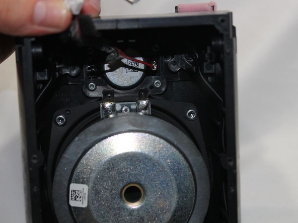

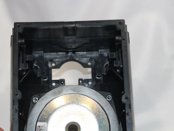

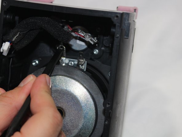

  17. Sonos One Tweeter Diaphragm Repair/ Replacement, Tweeter Diaphragm: crwdns2935265:017crwdnd2935265:01crwdnd2935265:03crwdne2935265:0 Sonos One Tweeter Diaphragm Repair/ Replacement, Tweeter Diaphragm: crwdns2935265:017crwdnd2935265:02crwdnd2935265:03crwdne2935265:0 Sonos One Tweeter Diaphragm Repair/ Replacement, Tweeter Diaphragm: crwdns2935265:017crwdnd2935265:03crwdnd2935265:03crwdne2935265:0
    • Disconnect the woofer cables.
    • If removing the tabs is difficult, the flat end of the spudger may be used to depress the middle tab and then the tab may be pulled to disconnect.

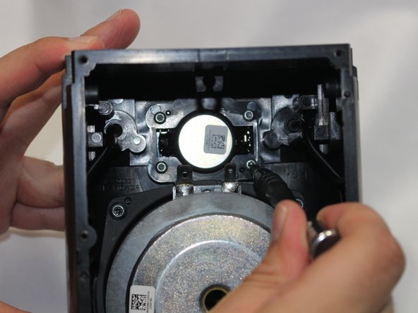

  18. Sonos One Tweeter Diaphragm Repair/ Replacement: crwdns2935265:018crwdnd2935265:01crwdnd2935265:03crwdne2935265:0 Sonos One Tweeter Diaphragm Repair/ Replacement: crwdns2935265:018crwdnd2935265:02crwdnd2935265:03crwdne2935265:0 Sonos One Tweeter Diaphragm Repair/ Replacement: crwdns2935265:018crwdnd2935265:03crwdnd2935265:03crwdne2935265:0
    • Disconnect the cables from the tweeter.
  19. Sonos One Tweeter Diaphragm Repair/ Replacement: crwdns2935265:019crwdnd2935265:01crwdnd2935265:03crwdne2935265:0 Sonos One Tweeter Diaphragm Repair/ Replacement: crwdns2935265:019crwdnd2935265:02crwdnd2935265:03crwdne2935265:0 Sonos One Tweeter Diaphragm Repair/ Replacement: crwdns2935265:019crwdnd2935265:03crwdnd2935265:03crwdne2935265:0
    • Remove the four 10mm Torx T10 screws from the tweeter.
    • Remove the tweeter from the speaker housing.
