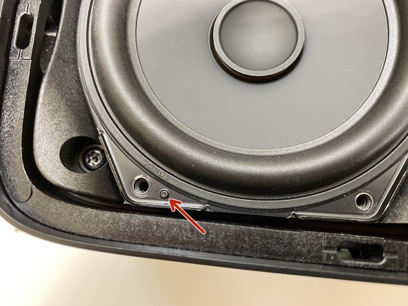

    3. Sonos Five Midwoofer Replacement, Left Midwoofer Removal: crwdns2935265:03crwdnd2935265:01crwdnd2935265:03crwdne2935265:0 Sonos Five Midwoofer Replacement, Left Midwoofer Removal: crwdns2935265:03crwdnd2935265:02crwdnd2935265:03crwdne2935265:0 Sonos Five Midwoofer Replacement, Left Midwoofer Removal: crwdns2935265:03crwdnd2935265:03crwdnd2935265:03crwdne2935265:0
      • Remove the four red circled Torx T20 screws securing the driver to the front panel.
      • Be sure to align the speaker properly with it's alignment posts during reinstallation (third photo, red arrow)

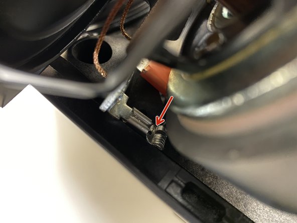

    4. Sonos Five Midwoofer Replacement, Disconnecting The Driver: crwdns2935265:04crwdnd2935265:01crwdnd2935265:03crwdne2935265:0 Sonos Five Midwoofer Replacement, Disconnecting The Driver: crwdns2935265:04crwdnd2935265:02crwdnd2935265:03crwdne2935265:0 Sonos Five Midwoofer Replacement, Disconnecting The Driver: crwdns2935265:04crwdnd2935265:03crwdnd2935265:03crwdne2935265:0
      • The insulated terminal simply pulls off to disconnect.
      • The non insulated terminal has a locking tab (red arrow, second photo). This tab that must be depressed with a small screwdriver to unlock it for removal.
      • The midwoofer may now be carefully removed from the supporting frame.

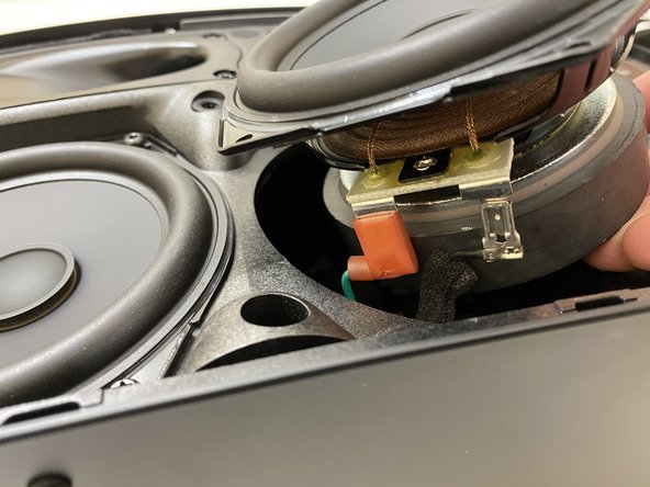

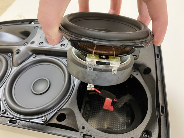

    5. Sonos Five Midwoofer Replacement, Center Midwoofer removal: crwdns2935265:05crwdnd2935265:01crwdnd2935265:03crwdne2935265:0 Sonos Five Midwoofer Replacement, Center Midwoofer removal: crwdns2935265:05crwdnd2935265:02crwdnd2935265:03crwdne2935265:0 Sonos Five Midwoofer Replacement, Center Midwoofer removal: crwdns2935265:05crwdnd2935265:03crwdnd2935265:03crwdne2935265:0
      • Raise the midwoofer out of the cabinet slightly to enable you to disconnect the terminals.
      • The center midwoofer driver wires are extremely short. Be Careful not to place too much tension on the wires. This takes two hands one holding the driver while you disconnect the terminals with the other.
      • Again, the insulated terminal simply slides off, but the non insulated terminal's locking tab must be depressed.

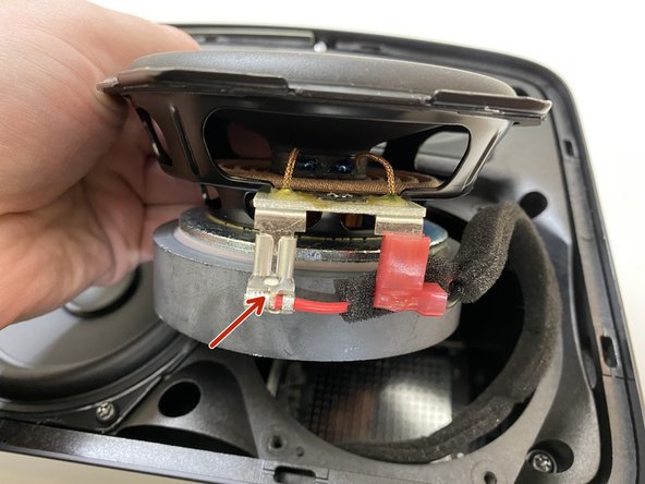

    6. Sonos Five Midwoofer Replacement, Right Midwoofer Removal: crwdns2935265:06crwdnd2935265:01crwdnd2935265:03crwdne2935265:0 Sonos Five Midwoofer Replacement, Right Midwoofer Removal: crwdns2935265:06crwdnd2935265:02crwdnd2935265:03crwdne2935265:0 Sonos Five Midwoofer Replacement, Right Midwoofer Removal: crwdns2935265:06crwdnd2935265:03crwdnd2935265:03crwdne2935265:0
      • Remove the four T20 screws securing the driver to the front panel
      • Lift the driver out of the cabinet.
      • The left noninsulated terminal again has a locking tab that must be depressed. (red arrow, photo two) The right terminal is simply pulled off.
