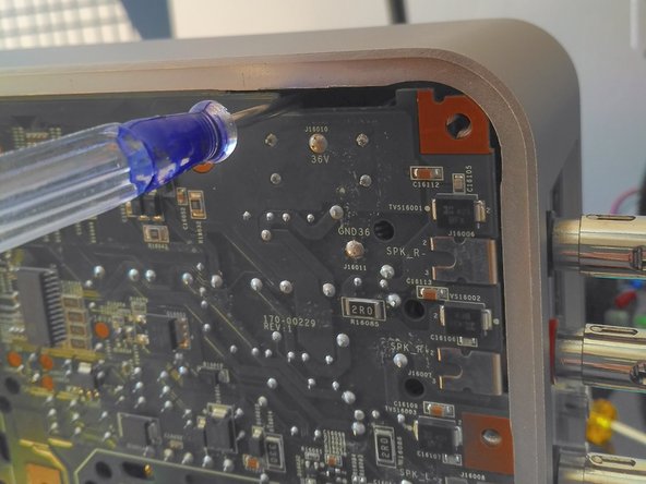

Sonos Connect Fuse Replacement
  1. Sonos Connect Fuse Replacement, Bottom Part: crwdns2935265:01crwdnd2935265:01crwdnd2935265:01crwdne2935265:0
    • Remove the rubber pads and unscrew
  2. Sonos Connect Fuse Replacement, Continue to unscrew: crwdns2935265:02crwdnd2935265:01crwdnd2935265:01crwdne2935265:0
    • Take care not to damage the wires of the Wi-Fi antennas which are very bothersome.
  3. Sonos Connect Fuse Replacement, Unclip the top cover: crwdns2935265:03crwdnd2935265:01crwdnd2935265:02crwdne2935265:0 Sonos Connect Fuse Replacement, Unclip the top cover: crwdns2935265:03crwdnd2935265:02crwdnd2935265:02crwdne2935265:0
    • By using a screwdriver inserted through each of the 8 peripheral slots, you can access the clips of the top cover.
  4. Sonos Connect Fuse Replacement, Access under the top cover: crwdns2935265:04crwdnd2935265:01crwdnd2935265:01crwdne2935265:0
    • Continue unscrewing (there is a screw under the seal).
  5. Sonos Connect Fuse Replacement, Locate the fuse: crwdns2935265:05crwdnd2935265:01crwdnd2935265:01crwdne2935265:0
    • It's a soldered fuse. You will need to desolder it from the back in order to replace it.
  6. Sonos Connect Fuse Replacement, Replacement fuse: crwdns2935265:06crwdnd2935265:01crwdnd2935265:01crwdne2935265:0
    • About 1$
    • 250V 5A T fuse (time delay).
