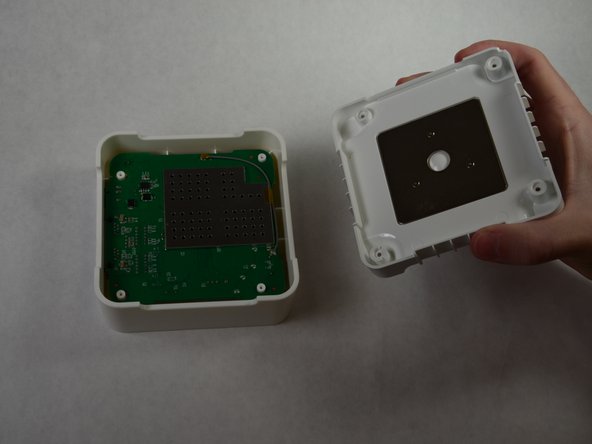

  3. Sonos Bridge Power Port Replacement: crwdns2935265:03crwdnd2935265:01crwdnd2935265:02crwdne2935265:0 Sonos Bridge Power Port Replacement: crwdns2935265:03crwdnd2935265:02crwdnd2935265:02crwdne2935265:0
    • Use the metal spudger to pry out the plastic bottom.
    • Alternatively, the casing can be lightly tapped on a table (base down) to drop the bottom out of the casing.

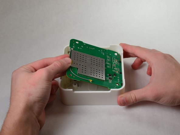

  4. Sonos Bridge Power Port Replacement: crwdns2935265:04crwdnd2935265:01crwdnd2935265:02crwdne2935265:0 Sonos Bridge Power Port Replacement: crwdns2935265:04crwdnd2935265:02crwdnd2935265:02crwdne2935265:0
    • Pry out the circuit board.
    • Place the metal spudger under the board on the side opposite the two ports.
    • The board can then be easily wiggled out of the casing.
    • This should NOT require significant force.

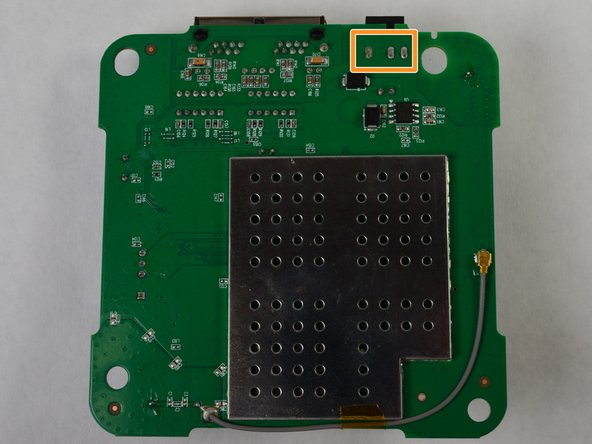

  5. Sonos Bridge Power Port Replacement: crwdns2935265:05crwdnd2935265:01crwdnd2935265:02crwdne2935265:0 Sonos Bridge Power Port Replacement: crwdns2935265:05crwdnd2935265:02crwdnd2935265:02crwdne2935265:0
    • Locate the Power port on the circuit board, shown with the red box in the first image.
    • Locate the solders attached to the Power port.
    • Use the soldering iron to undo the solders.
