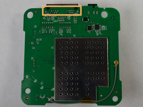

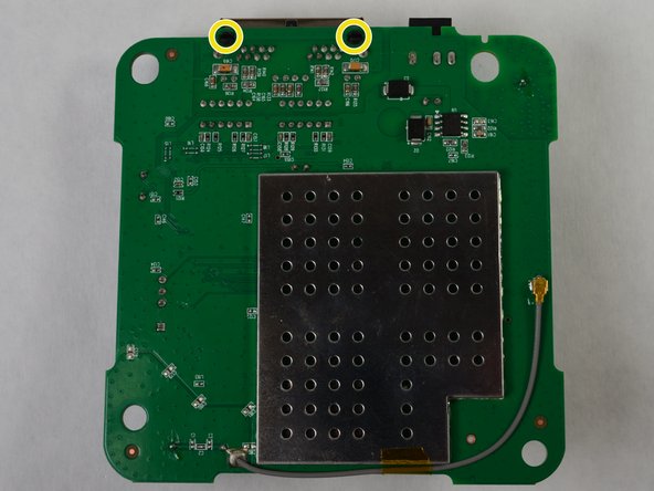

  5. Sonos Bridge Ethernet Port Replacement: crwdns2935265:05crwdnd2935265:01crwdnd2935265:03crwdne2935265:0 Sonos Bridge Ethernet Port Replacement: crwdns2935265:05crwdnd2935265:02crwdnd2935265:03crwdne2935265:0 Sonos Bridge Ethernet Port Replacement: crwdns2935265:05crwdnd2935265:03crwdnd2935265:03crwdne2935265:0
    • Locate the Ethernet port on the circuit board, shown with the red box in the first image.
    • Locate the solders attached to the Ethernet port.
    • Use the soldering iron to undo the solders.
    • Carefully remove the Ethernet port by using the metal spudger and squeezing the black clips.
