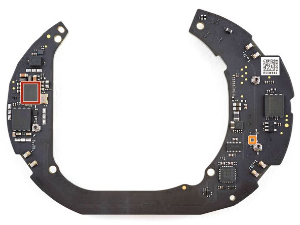

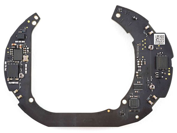

  1. Sonos Ace Chip ID, Left Earcup Main Board Side 1: crwdns2935265:01crwdnd2935265:01crwdnd2935265:02crwdne2935265:0 Sonos Ace Chip ID, Left Earcup Main Board Side 1: crwdns2935265:01crwdnd2935265:02crwdnd2935265:02crwdne2935265:0
    • Analog Devices ADAU1860‑1 audio codec w/ dual DSPs
    • Winbond W25Q128JW 16 MB serial flash memory
    • Richtek RT9471D 3 A single cell Li-ion battery charger
  2. Sonos Ace Chip ID, Left Earcup Main Board Side 2: crwdns2935265:02crwdnd2935265:01crwdnd2935265:02crwdne2935265:0 Sonos Ace Chip ID, Left Earcup Main Board Side 2: crwdns2935265:02crwdnd2935265:02crwdnd2935265:02crwdne2935265:0
    • STMicroelectronics STM32U575OG 32-bit ARM Cortex-M33 microcontroller
    • Microchip PIC16LF18323 8-bit microcontroller
    • Richtek RT9426A battery fuel gauge
    • STMicroelectronics TCPP03-M20 USB type-C power delivery protector
    • Richtek RT5715 2 A synchronous step-down converter
    • Nisshinbo Micro Devices RP114N181D 300 mA / 1.8 V LDO regulator
    • Nisshinbo Micro Devices RP114N301D 300 mA / 3.0 V LDO regulator
  3. Sonos Ace Chip ID: crwdns2935265:03crwdnd2935265:01crwdnd2935265:01crwdne2935265:0
    • Nisshinbo Micro Devices RP114N331D 300 mA / 3.3 V LDO regulator

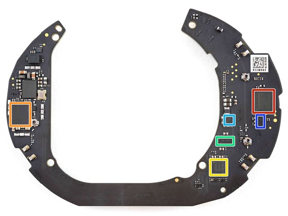

  4. Sonos Ace Chip ID, Right Earcup Main Board Side 1: crwdns2935265:04crwdnd2935265:01crwdnd2935265:02crwdne2935265:0 Sonos Ace Chip ID, Right Earcup Main Board Side 1: crwdns2935265:04crwdnd2935265:02crwdnd2935265:02crwdne2935265:0

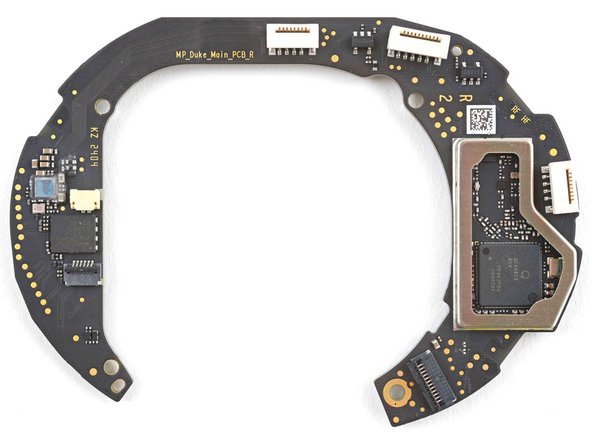

  5. Sonos Ace Chip ID, Right Earcup Main Board Side 1 - Connectivity: crwdns2935265:05crwdnd2935265:01crwdnd2935265:01crwdne2935265:0
  6. Sonos Ace Chip ID, Right Earcup Main Board Side 1 - Filters: crwdns2935265:06crwdnd2935265:01crwdnd2935265:01crwdne2935265:0

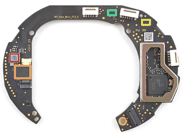

  7. Sonos Ace Chip ID, Right Earcup Main Board Side 2: crwdns2935265:07crwdnd2935265:01crwdnd2935265:02crwdne2935265:0 Sonos Ace Chip ID, Right Earcup Main Board Side 2: crwdns2935265:07crwdnd2935265:02crwdnd2935265:02crwdne2935265:0
    • Winbond W25Q16JV 2 MB serial flash memory
    • Diodes Incorporated PI4IOE5V6416 translating 16-bit I2C-bus I/O expander
    • Texas Instruments TXB0108 8-bit bidirectional voltage-level shifter

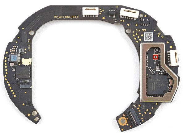

  8. Sonos Ace Chip ID, Right Earcup Main Board Side 2 - Connectivity: crwdns2935265:08crwdnd2935265:01crwdnd2935265:01crwdne2935265:0
  9. Sonos Ace Chip ID, Right Earcup Main Board Side 2 - Sensors: crwdns2935265:09crwdnd2935265:01crwdnd2935265:01crwdne2935265:0
    • Bosch Sensortec accelerometer & gyroscope
  10. Sonos Ace Chip ID, Right Earcup Main Board Side 2 - Filters: crwdns2935265:010crwdnd2935265:01crwdnd2935265:01crwdne2935265:0
