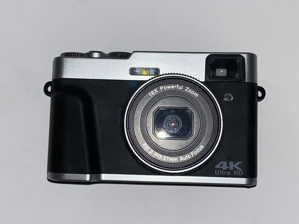

    • Here, I've got my hands on a camera that no longer works.
    • Seeing that I can't use it for anything useful, I decided to take it apart, because why not?

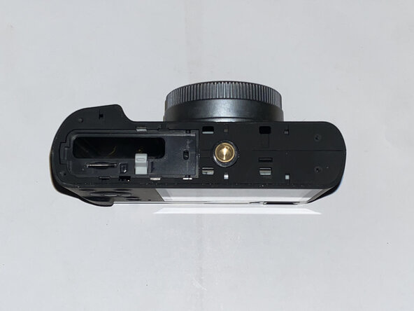

  2. Sonida DC202 Camera Teardown: crwdns2935265:02crwdnd2935265:01crwdnd2935265:02crwdne2935265:0 Sonida DC202 Camera Teardown: crwdns2935265:02crwdnd2935265:02crwdnd2935265:02crwdne2935265:0

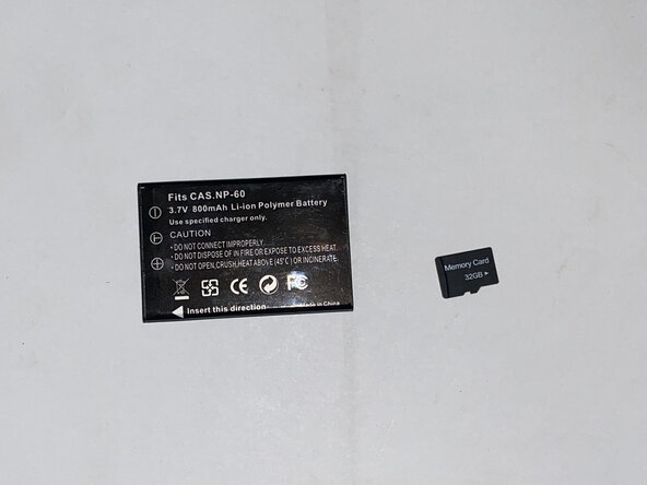

    • This camera came with two 3.7V 800mAh NP-60 li-pos and a generic 32GB microSD card.
    • The camera has a model number of DC202 and is manufactured by Shenzhen Sonida Digital Technology Co., Ltd.

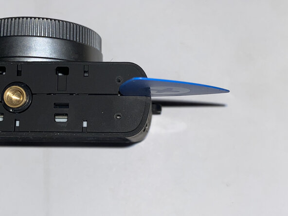

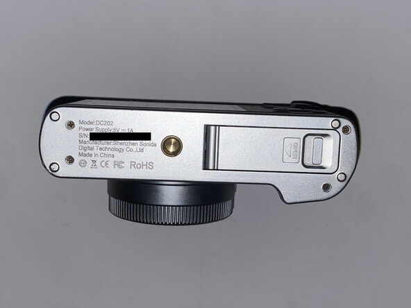

  3. Sonida DC202 Camera Teardown, Bottom Cover: crwdns2935265:03crwdnd2935265:01crwdnd2935265:03crwdne2935265:0 Sonida DC202 Camera Teardown, Bottom Cover: crwdns2935265:03crwdnd2935265:02crwdnd2935265:03crwdne2935265:0 Sonida DC202 Camera Teardown, Bottom Cover: crwdns2935265:03crwdnd2935265:03crwdnd2935265:03crwdne2935265:0

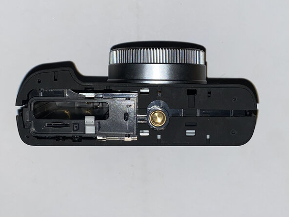

    • Time to start the teardown! Let's start by removing the bottom cover.
    • This revealed almost nothing about the insides of the camera, but did reveal that the rest the case (minus the silver plastic top cover) is split into two halves.

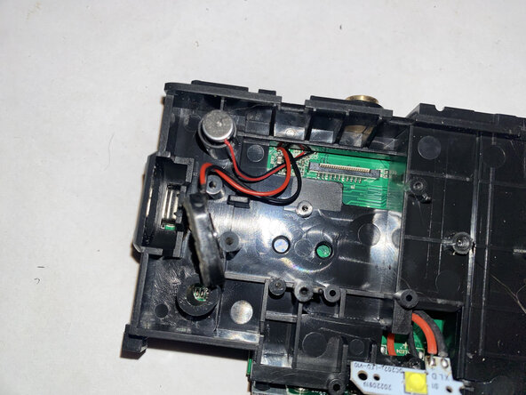

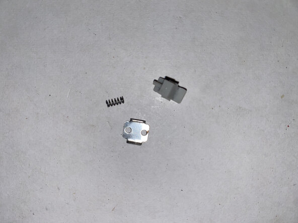

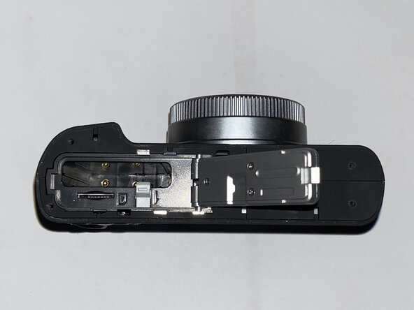

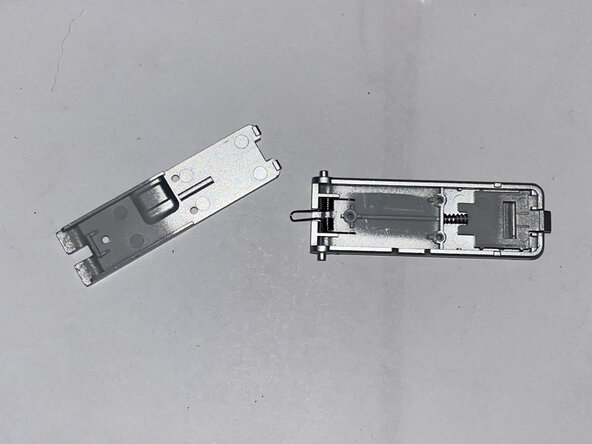

  4. Sonida DC202 Camera Teardown, Battery Door: crwdns2935265:04crwdnd2935265:01crwdnd2935265:02crwdne2935265:0 Sonida DC202 Camera Teardown, Battery Door: crwdns2935265:04crwdnd2935265:02crwdnd2935265:02crwdne2935265:0
    • I spot screws! Disassembling the battery door revealed some springs, but that's just about it.

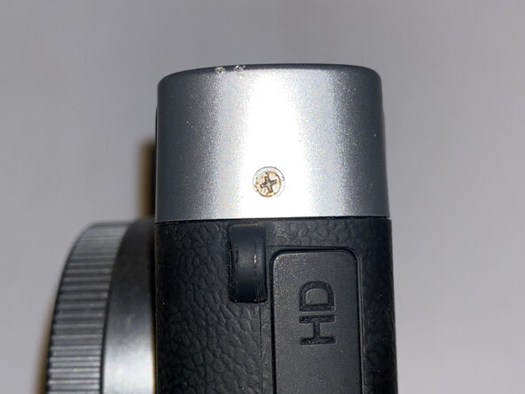

  5. Sonida DC202 Camera Teardown: crwdns2935265:05crwdnd2935265:01crwdnd2935265:03crwdne2935265:0 Sonida DC202 Camera Teardown: crwdns2935265:05crwdnd2935265:02crwdnd2935265:03crwdne2935265:0 Sonida DC202 Camera Teardown: crwdns2935265:05crwdnd2935265:03crwdnd2935265:03crwdne2935265:0
    • I stalled trying to figure out what to do next. I undid the two screws on the top cover, which didn't appear to do anything, so I tried separating the halves of the main part of the case. They separated all right, but they were still caught at the top.

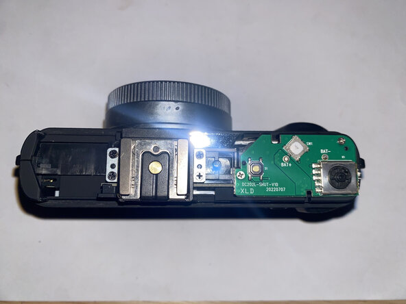

    • Breakthrough! I discovered that the top cover pops off almost as easily as the bottom cover (held on by just a few clips once the screws were removed).
    • The mode selector wheel flew off as I was removing its side of the cover. In retrospect, I probably should've taken it off first before I removed the rest of the cover.

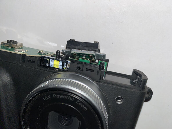

  8. Sonida DC202 Camera Teardown: crwdns2935265:08crwdnd2935265:01crwdnd2935265:02crwdne2935265:0 Sonida DC202 Camera Teardown: crwdns2935265:08crwdnd2935265:02crwdnd2935265:02crwdne2935265:0
    • The top cover revealed some circuitry, but removing the screws only allowed be to look underneath: both boards visible are soldered to the logic board.
    • Later, the button board needed to be bent upwards to allow further disassembly of the case.

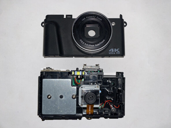

  9. Sonida DC202 Camera Teardown, Back Case: crwdns2935265:09crwdnd2935265:01crwdnd2935265:01crwdne2935265:0

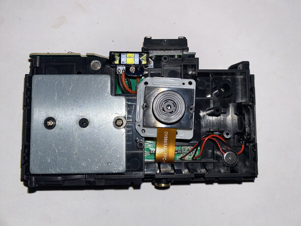

    • The back case simply popped out of place, revealing several components inside.

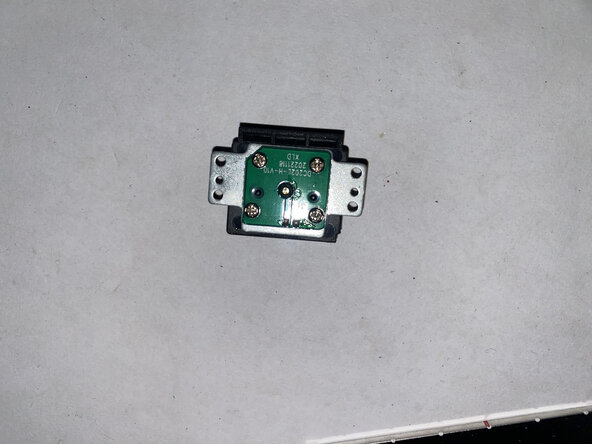

  10. Sonida DC202 Camera Teardown, Camera: crwdns2935265:010crwdnd2935265:01crwdnd2935265:03crwdne2935265:0 Sonida DC202 Camera Teardown, Camera: crwdns2935265:010crwdnd2935265:02crwdnd2935265:03crwdne2935265:0 Sonida DC202 Camera Teardown, Camera: crwdns2935265:010crwdnd2935265:03crwdnd2935265:03crwdne2935265:0

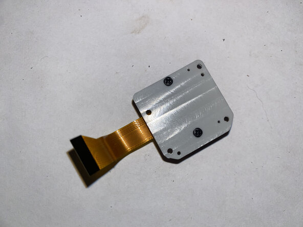

    • Camera, you're first! Removing and disassembling the camera module revealed that the component itself is tiny compared to the rest of the device.
    • The camera, labelled OV8865AF-FPC-V10-LF, is capable of taking photos at 3264 x 2448 (8 megapixels) at 30FPS. It can also record video at 1080p at 30FPS or half the resolution for double the FPS.
    • As a standalone unit, the camera module was marketed for mobile device cameras when it was in production.

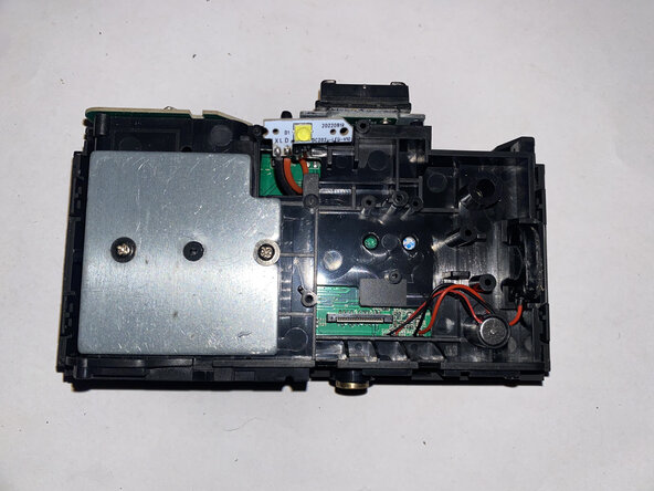

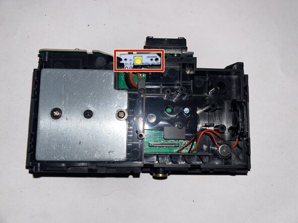

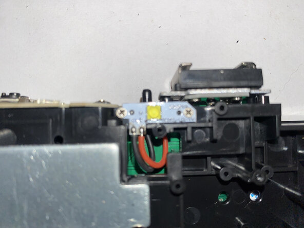

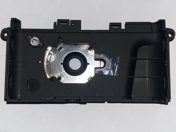

  11. Sonida DC202 Camera Teardown, Flash: crwdns2935265:011crwdnd2935265:01crwdnd2935265:01crwdne2935265:0
    • Removing the flash cover revealed more screws to remove the flash module, which is soldered to the logic board with two wires.

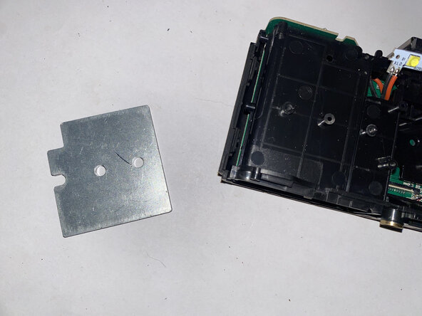

  12. Sonida DC202 Camera Teardown, Weight: crwdns2935265:012crwdnd2935265:01crwdnd2935265:01crwdne2935265:0
    • I was disappointed to learn that removing this metal plate, which turned out to be a weight, didn't reveal any screws or components.
    • It took me a while to figure out, but I believe this is here to act as a counterweight for the battery, which is on the other side of the camera.

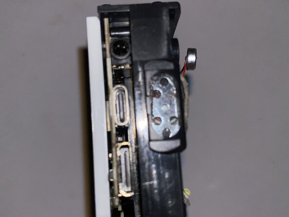

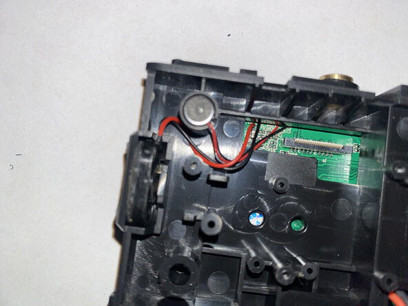

  13. Sonida DC202 Camera Teardown, Speaker and Microphone: crwdns2935265:013crwdnd2935265:01crwdnd2935265:03crwdne2935265:0 Sonida DC202 Camera Teardown, Speaker and Microphone: crwdns2935265:013crwdnd2935265:02crwdnd2935265:03crwdne2935265:0 Sonida DC202 Camera Teardown, Speaker and Microphone: crwdns2935265:013crwdnd2935265:03crwdnd2935265:03crwdne2935265:0
    • The microphone popped out with ease, but the speaker is glued in with a gasket of adhesive. While the adhesive is light, the speaker's positioning makes it more difficult to remove than it would've been if it could've been pried straight out.

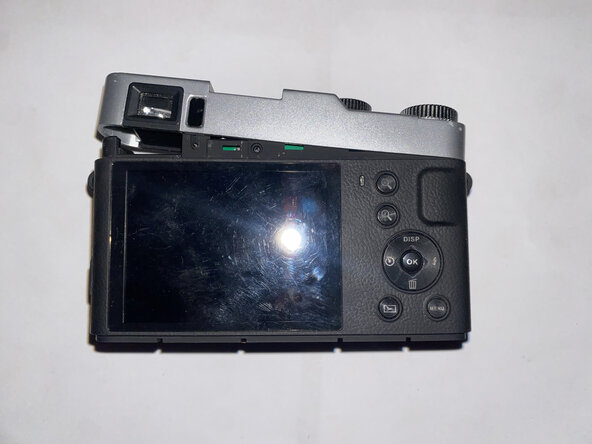

  14. Sonida DC202 Camera Teardown, Front Cover: crwdns2935265:014crwdnd2935265:01crwdnd2935265:02crwdne2935265:0 Sonida DC202 Camera Teardown, Front Cover: crwdns2935265:014crwdnd2935265:02crwdnd2935265:02crwdne2935265:0

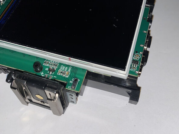

    • Time to remove the front cover! This revealed several buttons along with the screen.
    • I removed a screw near the bottom-left of the display that seemed to only hold down a small metal cover.

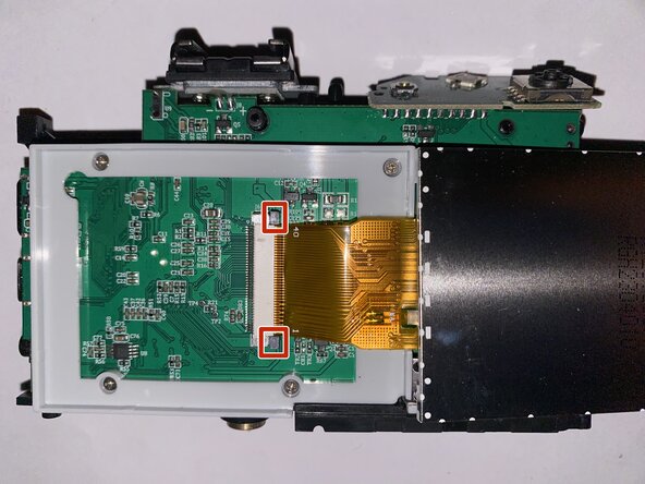

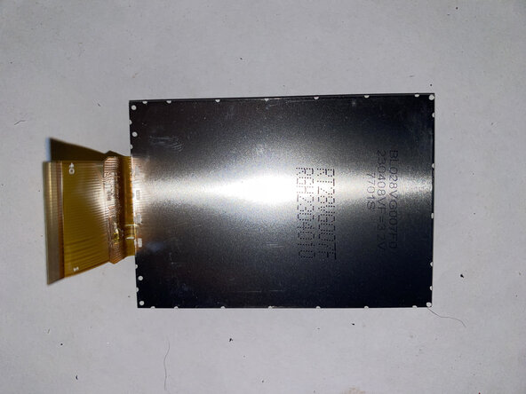

  15. Sonida DC202 Camera Teardown, Screen: crwdns2935265:015crwdnd2935265:01crwdnd2935265:03crwdne2935265:0 Sonida DC202 Camera Teardown, Screen: crwdns2935265:015crwdnd2935265:02crwdnd2935265:03crwdne2935265:0 Sonida DC202 Camera Teardown, Screen: crwdns2935265:015crwdnd2935265:03crwdnd2935265:03crwdne2935265:0
    • The screen was diffucult to separate from its light gray frame, but it was possible.
    • Unplugging the display cable requires the black tabs to be pulled out pulling out the cable.
    • Removing the screws around the display frame let the logic board free.
    • The display is labelled BL028VG007F0 230408VF=3.2V 7701S.

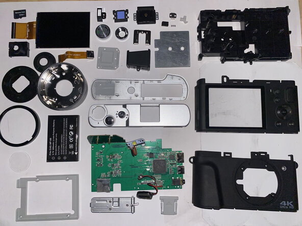

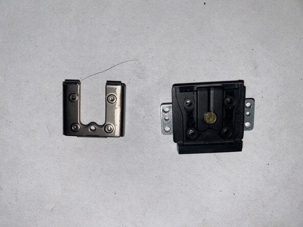

    • Some parts fell off while I was disassembling the device. The first picture shows the tiny metal cover and the battery locking mechanism, and the second and third show a part that broke off. (Whatever it is, it was seriously overbuilt. That thing had eight screws to undo!)

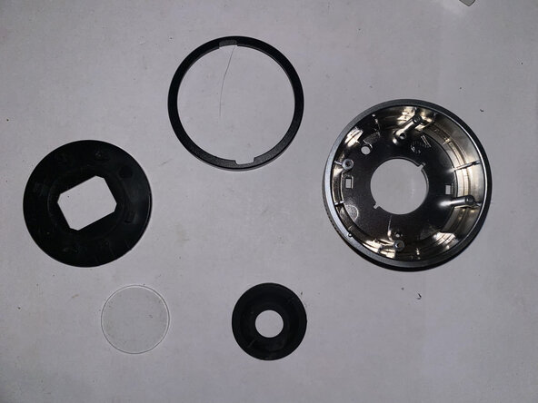

  17. Sonida DC202 Camera Teardown, Camera Bump: crwdns2935265:017crwdnd2935265:01crwdnd2935265:02crwdne2935265:0 Sonida DC202 Camera Teardown, Camera Bump: crwdns2935265:017crwdnd2935265:02crwdnd2935265:02crwdne2935265:0
    • Taking apart the back case separates some plastic bits from a gasket and the glass. (Yes, it's real glass.)

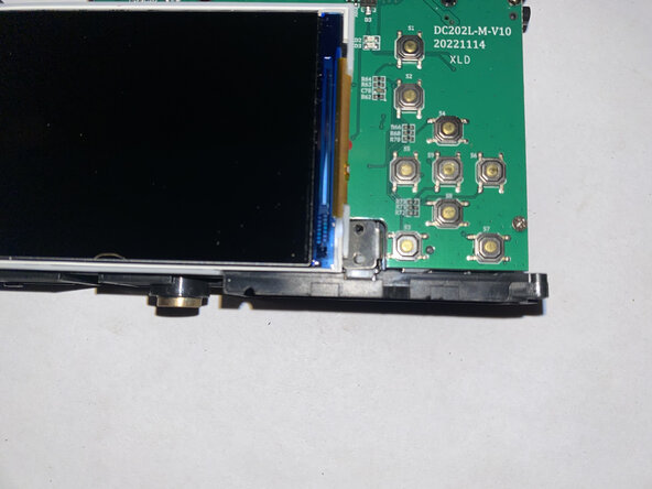

  18. Sonida DC202 Camera Teardown, Logic Board: crwdns2935265:018crwdnd2935265:01crwdnd2935265:02crwdne2935265:0 Sonida DC202 Camera Teardown, Logic Board: crwdns2935265:018crwdnd2935265:02crwdnd2935265:02crwdne2935265:0
    • Finally! The logic board!
    • On the front:
    • 2301 LUL083 PM230102 or 2301-EUL083 PM230102- probably an SoC or microcontroller.
    • PZS032SH 2KITA20 made by PLM
    • JL5001A 2101-BXA A1769G
    • On the back:
    • Not much! The board is labeled DC202L-M-V10 20221114 XLD. Searching for it on Google didn't show any results, so I'm guessing this is just for part identification within Sonida.
  19. Sonida DC202 Camera Teardown: crwdns2935265:019crwdnd2935265:01crwdnd2935265:01crwdne2935265:0
    • And that's it! The teardown is complete.
