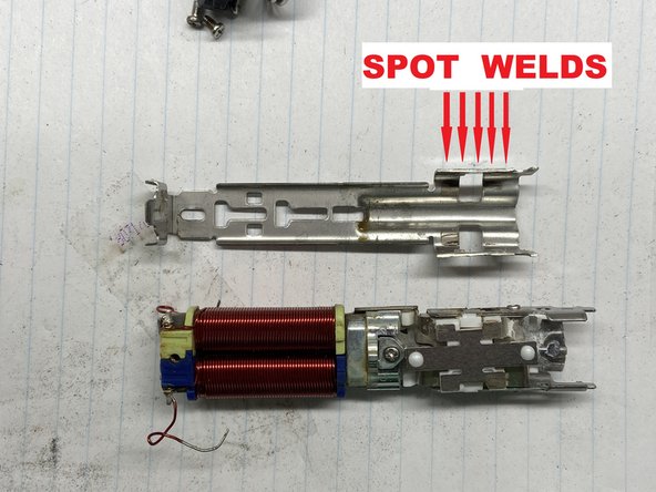

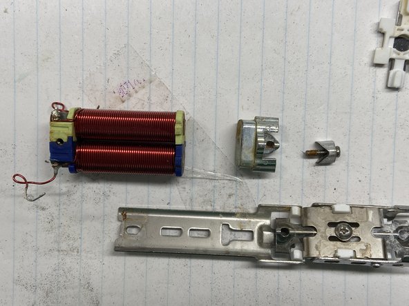

    • Detach motor assembly from battery holder. Cut through the spot welds (A Dremel tool and abrasive disk is what I used) and open the clamshell holding the motor assembly. Pull out motor, remove magnet attached to motor stator. This concludes teardown process.
