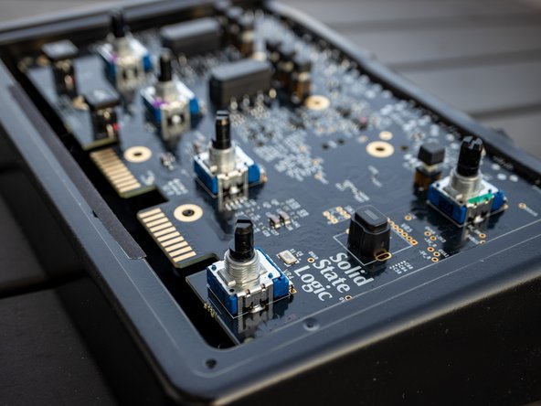

  3. Solid State Logic SSL 2 Teardown, Separate the front aluminium plate: crwdns2935265:03crwdnd2935265:01crwdnd2935265:02crwdne2935265:0 Solid State Logic SSL 2 Teardown, Separate the front aluminium plate: crwdns2935265:03crwdnd2935265:02crwdnd2935265:02crwdne2935265:0
    • The PCB is attached to the upper aluminium plate by nuts on the pots.
    • Use the 11 mm wrench to loosen the nuts.
    • Tighten just slightly during reassembly. Do not overtighten.

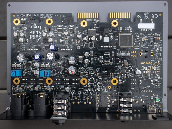

  4. Solid State Logic SSL 2 Teardown, Examine the back of the PCB roughly: crwdns2935265:04crwdnd2935265:01crwdnd2935265:02crwdne2935265:0 Solid State Logic SSL 2 Teardown, Examine the back of the PCB roughly: crwdns2935265:04crwdnd2935265:02crwdnd2935265:02crwdne2935265:0
    • The PCB is all black and has gold plated contacts and vias. SSL has two versions of this interface: SSL 2 and SSL 2+. The "+" version has more outputs and offers MIDI connectivity. For this reason, many components are missing from the circuit board shown here. Obviously, SSL uses the same PCB for both versions of the product.
    • Although the input sockets are combined XLR/TRS, the signal paths are separate. Nice!
    • SSL uses high quality, mostly Japanese, components (Alps, NJM, AKM, Nichicon, Panasonic) throughout the product. The connectors are made by Neutrik. Nice!

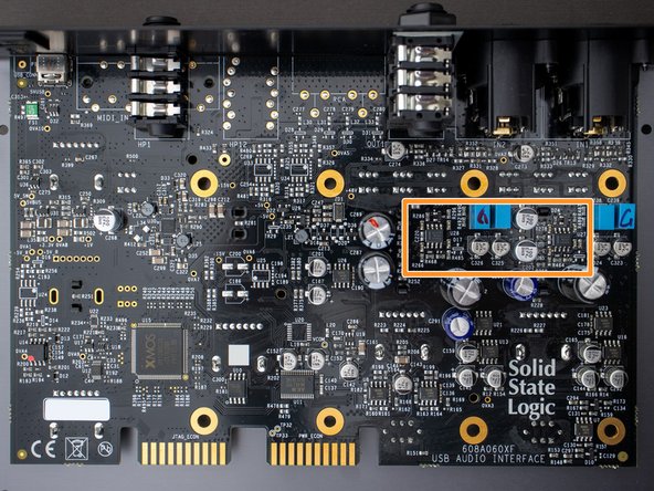

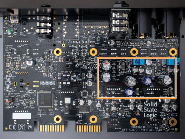

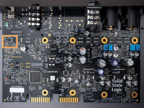

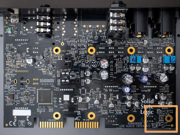

  6. Solid State Logic SSL 2 Teardown, Explore the 4K circuit: crwdns2935265:06crwdnd2935265:01crwdnd2935265:03crwdne2935265:0 Solid State Logic SSL 2 Teardown, Explore the 4K circuit: crwdns2935265:06crwdnd2935265:02crwdnd2935265:03crwdne2935265:0 Solid State Logic SSL 2 Teardown, Explore the 4K circuit: crwdns2935265:06crwdnd2935265:03crwdnd2935265:03crwdne2935265:0
    • NJM8065 (labelled 8065 902F JRC) by Japan Radio Company. High-gain, wide bandwidth, dual operational amplifier. Data sheet.
    • The NJM8065 combines many of the features of the NJM4558 as well as providing the capability of wider bandwidth (10MHz typ.), and higher slew rate (4V/μs typ.) make the NJM8065 ideal for active filters, data and telecommunications, and many instrumentation applications. (From the data sheet)
    • BAR 43S STM. Small signal Schottky diode.

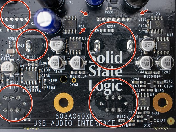

    • There are several resistors in the circuit: 188: 1.8 GΩ, 018: 100 MΩ, 102: 1 kΩ, 010: 1 Ω.
    • 4K switch soldering points.
    • The PCB was not properly cleaned of flux residues after soldering. High quality products are usually very clean.
    • The 4K Legacy circuit is boosts higher frequencies and adds harmonic distortion to the sound. This analog effect can work well in live broadcasts with darker microphones such as the Shure SM7B. On the other hand, the 4K circuitry seems to introduce more noise into the signal. I recommend leaving it off for high quality recordings.
    • I like the idea of being able to have switchable effects in the signal path. Audio interfaces are often used in live streaming situations where it is important to be able to change the sound during the stream, and digital effects would add an unwanted delay. Perhaps SSL could integrate an analog compressor and equalizer into their next interface.

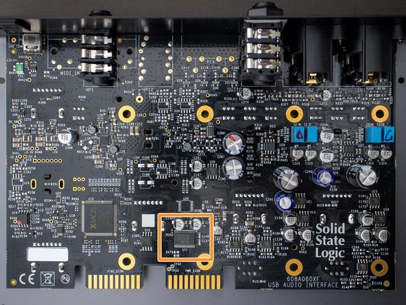

  7. Solid State Logic SSL 2 Teardown, Notice the AKM converter: crwdns2935265:07crwdnd2935265:01crwdnd2935265:02crwdne2935265:0 Solid State Logic SSL 2 Teardown, Notice the AKM converter: crwdns2935265:07crwdnd2935265:02crwdnd2935265:02crwdne2935265:0
    • AKM AK4621EF CODEC by Asahi Kasei Microdevices. 115dB 192kHz 24-bit 2 ch ADC & 2 ch DAC with Low Latency Digital Filter. Website, Data sheet.
    • The AK4621EF is a high performance 24-bit CODEC that supports up to 192kHz recording and playback. The on-board analog-to-digital converter has a high dynamic range due to AKM’s Enhanced Dual-Bit architecture. (From the data sheet)
    • The DAC utilizes AKM’s Advanced Multi-Bit architecture that achieves low out-of-band noise and high jitter tolerance through the use of Switched Capacitor Filter (SCF) technology. (From the data sheet)

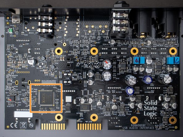

  8. Solid State Logic SSL 2 Teardown, Find the Microcontroller: crwdns2935265:08crwdnd2935265:01crwdnd2935265:02crwdne2935265:0 Solid State Logic SSL 2 Teardown, Find the Microcontroller: crwdns2935265:08crwdnd2935265:02crwdnd2935265:02crwdne2935265:0
    • XMOS XU212-256-FB236 (marked XMOS U11280C20). xCORE Multicore Microcontroller. Standalone real-time RISC processor. Data sheet.
    • This is the actual interface which manages the whole I-O work and timings.
    • The xCORE200 Series is a range of 32-bit multicore microcontrollers brings the low latency and timing determinism of the xCORE architecture to mainstream embedded applications. xCORE multicore microcontrollers execute multiple real-time tasks simultaneously and communicate between tasks using a high speed network. (From the data sheet)

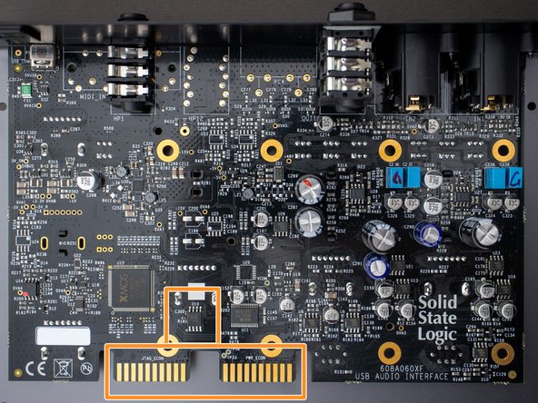

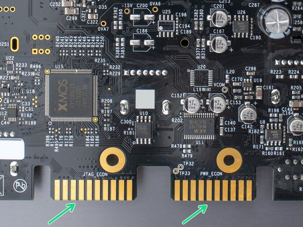

  9. Solid State Logic SSL 2 Teardown, Find the flash for firmware and JTAG connector: crwdns2935265:09crwdnd2935265:01crwdnd2935265:03crwdne2935265:0 Solid State Logic SSL 2 Teardown, Find the flash for firmware and JTAG connector: crwdns2935265:09crwdnd2935265:02crwdnd2935265:03crwdne2935265:0 Solid State Logic SSL 2 Teardown, Find the flash for firmware and JTAG connector: crwdns2935265:09crwdnd2935265:03crwdnd2935265:03crwdne2935265:0
    • MXIC MX 25L8006E M2I-12G, 8MBit SPI Flash, SOIC-8 CMOS Serial flash. Data sheet.
    • The 10 lines JTAG and PWR connectors are most probably used for flashing the device during production.
    • Those connectors are suspicious: Solid State Logic uses the same connectors for their 500 series console modules. Can the interface be used in a different setting? All connections seem to go somewhere.

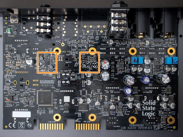

  10. Solid State Logic SSL 2 Teardown, Explore the 8068 OP-Amps: crwdns2935265:010crwdnd2935265:01crwdnd2935265:02crwdne2935265:0 Solid State Logic SSL 2 Teardown, Explore the 8068 OP-Amps: crwdns2935265:010crwdnd2935265:02crwdnd2935265:02crwdne2935265:0
    • NJM8068 (marked 8068 906F JRC) by Japan Radio Company. Low noise bipolar input dual audio operational amplifier. Website, Data sheet.
    • The NJM8068 features Low distortion, high slew rate, wide bandwidth and high open-loop gain. In addition, unity-gain stable allows voltage-follower operation. These features make NJM8068 ideal for audio pre amplifier, microphone amplifier, line amplifier and other audio applications. (From the data sheet)
  11. Solid State Logic SSL 2 Teardown, Explore the 8080 OP-Amps: crwdns2935265:011crwdnd2935265:01crwdnd2935265:02crwdne2935265:0 Solid State Logic SSL 2 Teardown, Explore the 8080 OP-Amps: crwdns2935265:011crwdnd2935265:02crwdnd2935265:02crwdne2935265:0
    • NJM8080 (marked 8080 945F JRC) by Japan Radio Company. Dual operational amplifier designed for high quality audio applications. Data sheet.
    • The NJM8080 features high resolution and crispy-clear high frequency sound, which can fully perform the digital sound source with loss-less. NJM8080 features low noise, wide gain-bandwidth, low distortion and high output current, and various reliabilities and conveniences are improved. (From the data sheet)
  12. Solid State Logic SSL 2 Teardown, Explore the 1678 OP-Amps: crwdns2935265:012crwdnd2935265:01crwdnd2935265:02crwdne2935265:0 Solid State Logic SSL 2 Teardown, Explore the 1678 OP-Amps: crwdns2935265:012crwdnd2935265:02crwdnd2935265:02crwdne2935265:0
    • OPA1678 (marked OP1678) by Texas Instruments. Dual channel low noise low distortion operational amplifiers. Data sheet.
    • The OPA167x amplifiers achieve a low 4.5-nV/√Hz noise density and low distortion of 0.0001% at 1 kHz, which improves audio signal fidelity. They also offer rail-to-rail output swing to within 800 mV with a 2-kΩ load, which increases headroom and maximizes dynamic range. (From the data sheet)
    • The OPA1678 and operate over a very wide supply range of ±2.25 V to ±18 V or (4.5 V to 36 V) on only 2 mA of supply current to accommodate the power supply constraints of many types of audio products. These op amps are unitygain stable and have excellent dynamic behavior over a wide range of load conditions. (From the data sheet)
    • The OPA167x amplifiers use completely independent internal circuitry for lowest crosstalk and freedom from interactions between channels, even when overdriven or overloaded. (From the data sheet)

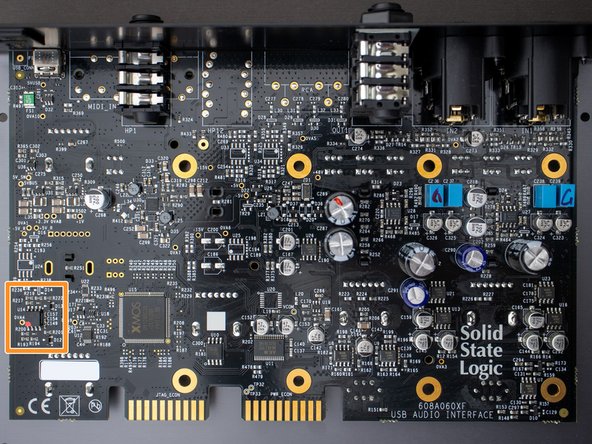

  14. Solid State Logic SSL 2 Teardown, Investigate the voltage regulator: crwdns2935265:014crwdnd2935265:01crwdnd2935265:02crwdne2935265:0 Solid State Logic SSL 2 Teardown, Investigate the voltage regulator: crwdns2935265:014crwdnd2935265:02crwdnd2935265:02crwdne2935265:0
    • Richtek RT9179 (marked XA9J8) 300mA linear voltage regulator. Data Sheet.

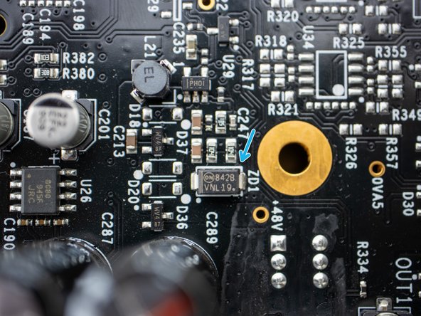

  15. Solid State Logic SSL 2 Teardown, Investigate the +48V phantom power supply: crwdns2935265:015crwdnd2935265:01crwdnd2935265:03crwdne2935265:0 Solid State Logic SSL 2 Teardown, Investigate the +48V phantom power supply: crwdns2935265:015crwdnd2935265:02crwdnd2935265:03crwdne2935265:0 Solid State Logic SSL 2 Teardown, Investigate the +48V phantom power supply: crwdns2935265:015crwdnd2935265:03crwdnd2935265:03crwdne2935265:0
    • TPS65130 by Texas Instruments. Split-Rail Converter with Dual, Positive and Negative Outputs. Data sheet.
    • ON 842B Zener Diode.

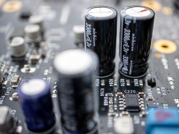

  17. Solid State Logic SSL 2 Teardown, Look at the large capacitors: crwdns2935265:017crwdnd2935265:01crwdnd2935265:03crwdne2935265:0 Solid State Logic SSL 2 Teardown, Look at the large capacitors: crwdns2935265:017crwdnd2935265:02crwdnd2935265:03crwdne2935265:0 Solid State Logic SSL 2 Teardown, Look at the large capacitors: crwdns2935265:017crwdnd2935265:03crwdnd2935265:03crwdne2935265:0
    • The big black ones are made by Nichicon and the smaller blue ones by Panasonic. Nice!

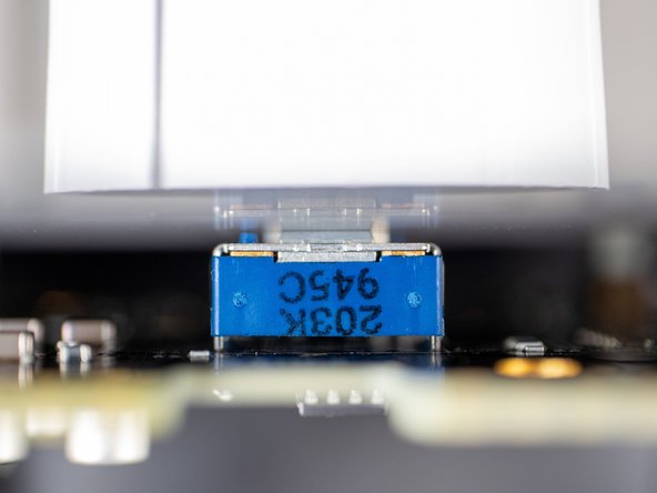

  18. Solid State Logic SSL 2 Teardown, Look at the potentiometers: crwdns2935265:018crwdnd2935265:01crwdnd2935265:02crwdne2935265:0 Solid State Logic SSL 2 Teardown, Look at the potentiometers: crwdns2935265:018crwdnd2935265:02crwdnd2935265:02crwdne2935265:0
    • All potentiometers are made by ALPS (marked 203K 945C). Nice!

Very nice photos! As a pro EE though, just wanted to correct a few misconceptions in step 6:
Flux: if they used the right type of flux, leaving it on is fine. Many switches and potentiometers can’t be “washed” because they’re not sealed (the liquid would get stuck inside), so after SMT assembly and cleaning, these are usually hand-soldered separately using “no-clean” flux - this class of fluxes is non-corrosive and safe to leave on the board permanently. The only reasons to clean flux off the board are DC leakage currents (which only matter for pA or fA measurements, nothing in the audio realm will matter at all in this way) or corrosion (if you’re not using a no-clean flux).
Resistor values: definitely no gigaohm values; leakage around the resistors is probably in the gigaohm range. These are using the EIA-96 style resistor codes, which are standard on 0603 and smaller - I can see how it would be easy to misread the “B”s as “8”s. The schematic for each channel looks something like this.
