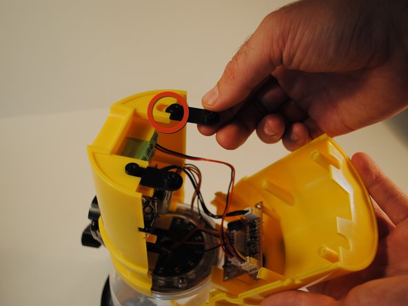

    • To disassemble the main body, grip the lantern so that the front half of the body with the power button on it is in your right hand and the back half with the hand crank is in your left.
    • Pinch the front half of the body on both sides with your thumb and index finger just below the first extruding rim of the front plate while simultaneously pulling the back half away. This may take some effort to do.
    • Be careful to not pull the halves of the body away from each other too hard because the internal wires connecting internal components may break.
    • Take note to remove and set aside black screw mounts located in between the halves at the bottom of the lantern.
    • When putting the front and back plates together during reassembly, make sure to slide the extruding screws from the base of the globe through the corresponding grooves cut into the top of the front and back plates of the main body.

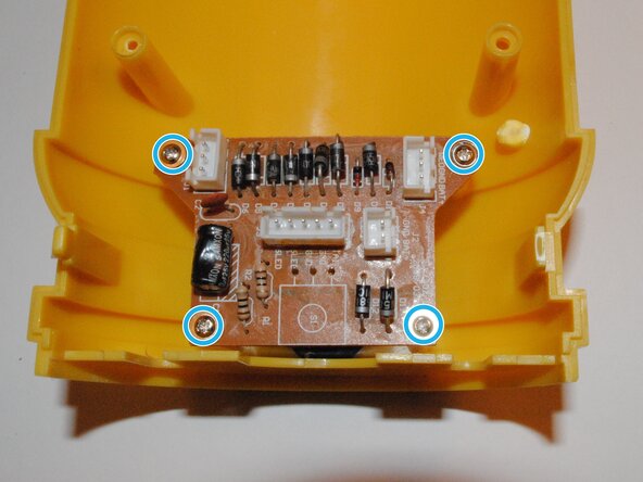

    • The main power board is located directly behind the power button, screwed into the front plate.
    • Disconnect all the wires from the main power board by removing the white clips from their corresponding sockets mounted on the board.
    • For reference to replace wires, see labeled picture of main board.
    • LED.
    • DC-in board.
    • Battery.
    • Crank.
    • With the Philips #0 screwdriver, unscrew the four screws mounting the board to the front plate. Remove the board from the front plate. Set aside screws for reassembly.

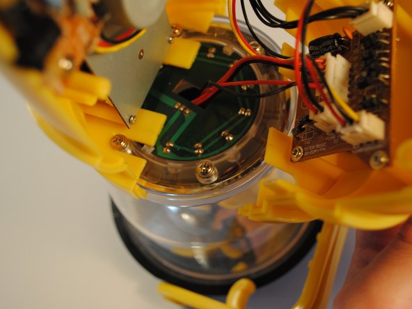

  7. SolaDyne LED Lantern Main Power Board Replacement: crwdns2935265:07crwdnd2935265:01crwdnd2935265:01crwdne2935265:0
    • Replace all the wires from components into the new main board. Trace the wire from each component and insert where specified on the diagram.
    • Make sure grooves on the clip holding the wires together for each component align with the pins in the socket on the main board before inserting.
