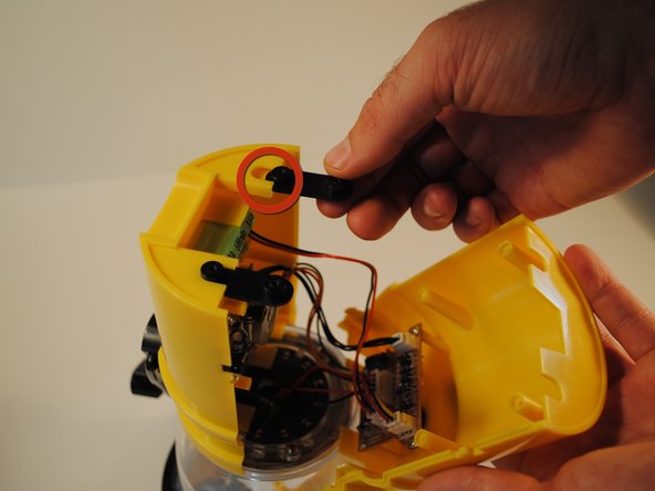

    • To disassemble the main body, grip the lantern so that the front half of the body with the power button on it is in your right hand and the back half with the hand crank is in your left.
    • Pinch the front half of the body on both sides with your thumb and index finger just below the first extruding rim of the front plate while simultaneously pulling the back half away. This may take some effort to do.
    • Be careful to not pull the halves of the body away from each other too hard because the internal wires connecting internal components may break.
    • Take note to remove and set aside black screw mounts located in between the halves at the bottom of the lantern.
    • When putting the front and back plates together during reassembly, make sure to slide the extruding screws from the base of the globe through the corresponding grooves cut into the top of the front and back plates of the main body.

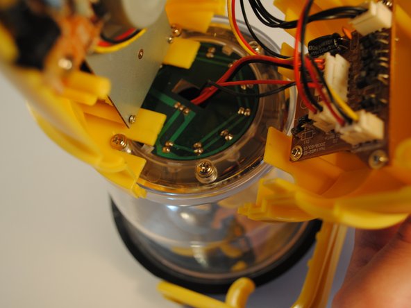

    • The main power board is located directly behind the power button, screwed into the front plate.
    • Locate the LED board. It is located in the base of the globe, with the LEDs extending up inside the globe.
    • Trace the wires coming from the LED board to the main board. Pull out the white clip connecting the wires from the LED board from the socket on the main board. This will sever the electrical connection between the LED board and the rest of the lantern.
    • In this case, the white clip contains wires from both the LED board and the top solar panel. In order to replace the LED board, the wires connected to the solar panel must be unsoldered.

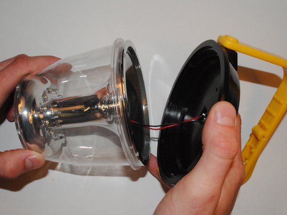

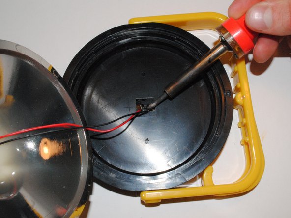

    • Grip the globe of the lantern and turn the top lid of the lantern counter-clockwise so it can be removed.
    • Be careful not to pull the lid off with too much force because the wires connecting the solar panel are attached to the main board, and may damage the main board.
    • Place the lid, with the solar panel down, on the table. Unsolder the two wires connected to the solar panel.
    • Feed wires from solar panel down the main shaft running through the middle of the globe.

    • Feed the two disconnected wires from the white clip back up through the main shaft of the globe to the top portion of the lantern where the lid attaches.
    • Solder the new wires to the base of the solar panel.
    • Reattach the lid to top of the lantern by aligning grooves and turning clockwise.
