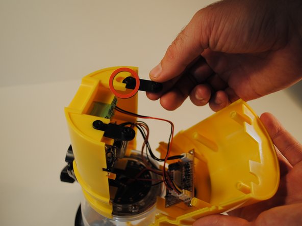

    • To disassemble the main body, grip the lantern so that the front half of the body with the power button on it is in your right hand and the back half with the hand crank is in your left.
    • Pinch the front half of the body on both sides with your thumb and index finger just below the first extruding rim of the front plate while simultaneously pulling the back half away. This may take some effort to do.
    • Be careful to not pull the halves of the body away from each other too hard because the internal wires connecting internal components may break.
    • Take note to remove and set aside black screw mounts located in between the halves at the bottom of the lantern.
    • When putting the front and back plates together during reassembly, make sure to slide the extruding screws from the base of the globe through the corresponding grooves cut into the top of the front and back plates of the main body.

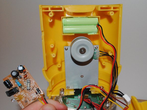

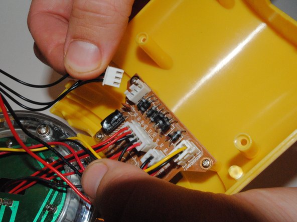

  5. SolaDyne LED Lantern Hand Crank Replacement: crwdns2935265:05crwdnd2935265:01crwdnd2935265:01crwdne2935265:0
    • The main power board is located directly behind the power button, screwed into the front plate.
    • Locate the crank dynamo component. It is mounted on the back plate directly above the battery.
    • Trace the wires from the dynamo component to the main power board. Pull out the white clip from the socket on the main board. This will sever the electrical connection between the crank dynamo and the rest of the lantern.

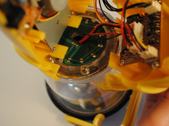

  6. SolaDyne LED Lantern Hand Crank Replacement: crwdns2935265:06crwdnd2935265:01crwdnd2935265:02crwdne2935265:0 SolaDyne LED Lantern Hand Crank Replacement: crwdns2935265:06crwdnd2935265:02crwdnd2935265:02crwdne2935265:0
    • Locate the DC-in board. It is mounted onto the back plate slightly covering the bottom right corner of the crank dynamo.
    • Remove the two screws mounting the DC-in board.
    • Set screws aside for reassembly.
    • Move the DC-in chip out of the way in order to access the crank dynamo.
