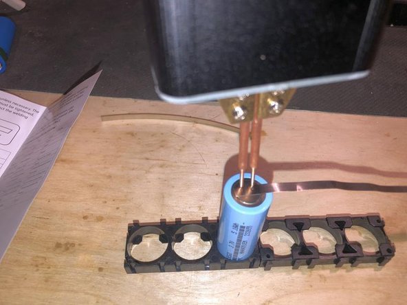

    • Here is the spot welder being used and it's settings are indicated by the blue LED's

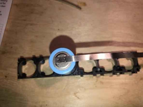

    • Lay teh nickel strip straight on the battery contact and use the spot welder according to its instructions. This one does not have a trigger and will weld when it senses contact with both post.
    • Nickel strip solidly attached. The miss on the top is related to not wearing eyeglass when needed :-)

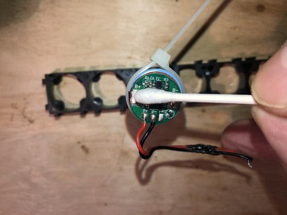

    • Bottom or Negative Strip welded to battery. Use the battery control board to ensure the direction of the Top or Positive Strip.
    • Spot weld the Top or Positive strip the same way as prior done with the negative. Place the strip at a 180 degree from the negative
    • Now bend the Bottom or Negative strip up while having it tight to the body of the battery. Use something like a rubber band, or zip tie etc to ensure it is close to the body.
  8. Sol Republic Punk Preparing a new battery for Replacement: crwdns2935265:08crwdnd2935265:01crwdnd2935265:03crwdne2935265:0 Sol Republic Punk Preparing a new battery for Replacement: crwdns2935265:08crwdnd2935265:02crwdnd2935265:03crwdne2935265:0 Sol Republic Punk Preparing a new battery for Replacement: crwdns2935265:08crwdnd2935265:03crwdnd2935265:03crwdne2935265:0

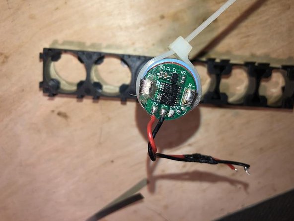

    • Place the battery controller on the top and measure the Negative strip. Bend it and cut it so it covers the solder pad. Do the same for the Positive strip
    • Then solder both tabs to the battery control board in conventional manner.
    • After soldering clean the flux with a cotton tip applicator and some isopropyl alcohol
