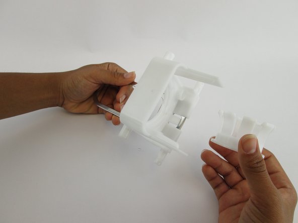

  18. SodaStream Source Loader Tab Replacement: crwdns2935265:018crwdnd2935265:01crwdnd2935265:03crwdne2935265:0 SodaStream Source Loader Tab Replacement: crwdns2935265:018crwdnd2935265:02crwdnd2935265:03crwdne2935265:0 SodaStream Source Loader Tab Replacement: crwdns2935265:018crwdnd2935265:03crwdnd2935265:03crwdne2935265:0
    • Pull the foam pad up and remove it from the front side of the carbonation component.

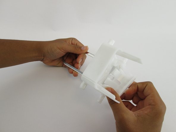

  19. SodaStream Source Loader Tab Replacement: crwdns2935265:019crwdnd2935265:01crwdnd2935265:01crwdne2935265:0
    • Remove the six 17.7 mm screws from the underside of the loader tab piece.
  20. SodaStream Source Loader Tab Replacement: crwdns2935265:020crwdnd2935265:01crwdnd2935265:03crwdne2935265:0 SodaStream Source Loader Tab Replacement: crwdns2935265:020crwdnd2935265:02crwdnd2935265:03crwdne2935265:0 SodaStream Source Loader Tab Replacement: crwdns2935265:020crwdnd2935265:03crwdnd2935265:03crwdne2935265:0
    • Pull the loader tab out of the nozzle.
  21. SodaStream Source Loader Tab Replacement, Loader Tab: crwdns2935265:021crwdnd2935265:01crwdnd2935265:03crwdne2935265:0 SodaStream Source Loader Tab Replacement, Loader Tab: crwdns2935265:021crwdnd2935265:02crwdnd2935265:03crwdne2935265:0 SodaStream Source Loader Tab Replacement, Loader Tab: crwdns2935265:021crwdnd2935265:03crwdnd2935265:03crwdne2935265:0
    • Pull the small inner plastic circle out of the large plastic loader tab piece.
