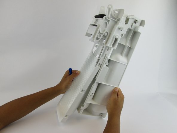

    12. SodaStream Source Internal Carbonation Air Hose  Replacement: crwdns2935265:017crwdnd2935265:01crwdnd2935265:01crwdne2935265:0
      • Grip the right and left sides of the device and pull it into two identical halves.
      • Once these two pieces are apart, all remaining internal components will fall out of the device.
    13. SodaStream Source Internal Carbonation Air Hose  Replacement: crwdns2935265:018crwdnd2935265:01crwdnd2935265:03crwdne2935265:0 SodaStream Source Internal Carbonation Air Hose  Replacement: crwdns2935265:018crwdnd2935265:02crwdnd2935265:03crwdne2935265:0 SodaStream Source Internal Carbonation Air Hose  Replacement: crwdns2935265:018crwdnd2935265:03crwdnd2935265:03crwdne2935265:0
      • Pull the foam pad up and remove it from the front side of the carbonation component.

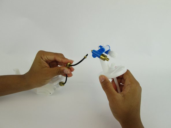

    1. SodaStream Source Internal Carbonation Air Hose  Replacement, Internal Carbonation Air Hose: crwdns2935265:021crwdnd2935265:01crwdnd2935265:02crwdne2935265:0 SodaStream Source Internal Carbonation Air Hose  Replacement, Internal Carbonation Air Hose: crwdns2935265:021crwdnd2935265:02crwdnd2935265:02crwdne2935265:0
      • Use pliers to unscrew the gold cap piece from both ends of the tube

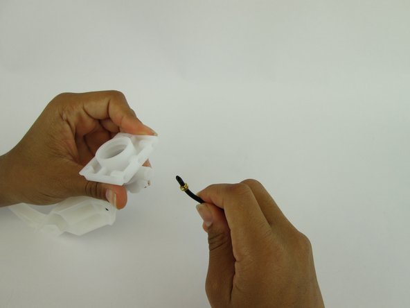

    2. SodaStream Source Internal Carbonation Air Hose  Replacement: crwdns2935265:022crwdnd2935265:01crwdnd2935265:03crwdne2935265:0 SodaStream Source Internal Carbonation Air Hose  Replacement: crwdns2935265:022crwdnd2935265:02crwdnd2935265:03crwdne2935265:0 SodaStream Source Internal Carbonation Air Hose  Replacement: crwdns2935265:022crwdnd2935265:03crwdnd2935265:03crwdne2935265:0
      • Detach the hose from both sides of the carbonation system.
      • You will have to use force to detach this piece.
