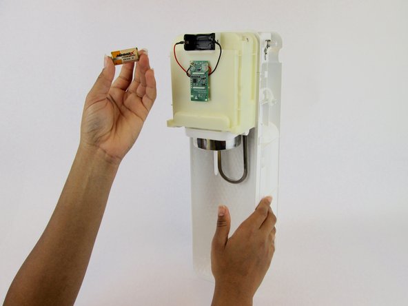

The SodaStream Source is operated by a 3V lithium battery. If you are experiencing trouble with your device not turning on, or your LED lights are not coming on it could be that your battery needs to be replaced. This guide will instruct you on how to remove the carbonation block and replace the internal battery.

      • Remove the soda bottle and the CO₂ canister from the machine.

      • Pull the outer cover away from the front of the device.

      • Firmly pull the front cover off.
      • This piece is difficult to remove and requires force. It may help to use a wide, thin object to pry it off (like a Jimmy).
    1. SodaStream Source Battery Replacement, Battery: crwdns2935265:06crwdnd2935265:01crwdnd2935265:02crwdne2935265:0 SodaStream Source Battery Replacement, Battery: crwdns2935265:06crwdnd2935265:02crwdnd2935265:02crwdne2935265:0
      • Remove the old battery and replace it with a new 3V lithium battery.

Heel de achterkant hoeft er hiervoor niet af hoor juist de voorkant 2 vijsjes en je kan het voorste deksel er af klikken ;)
tomclaes1989 - crwdns2934203:0crwdne2934203:0 crwdns2950251:0crwdne2950251:0
Perfectly explained! I was afraid to pull the front cover because it does indeed take a lot of force to pull off!!
its important to note it’s a C123A 3v battery, not the C2 3v as I found out after opening
