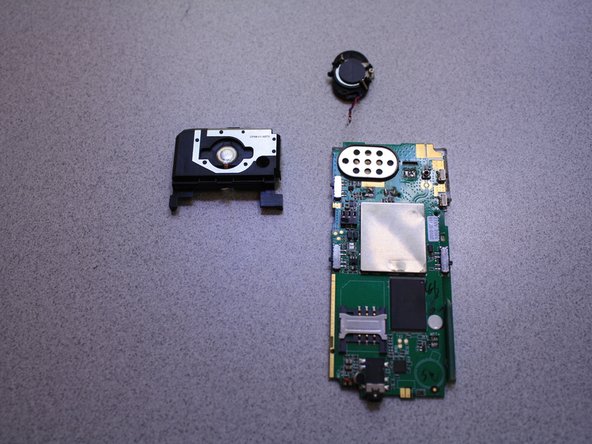

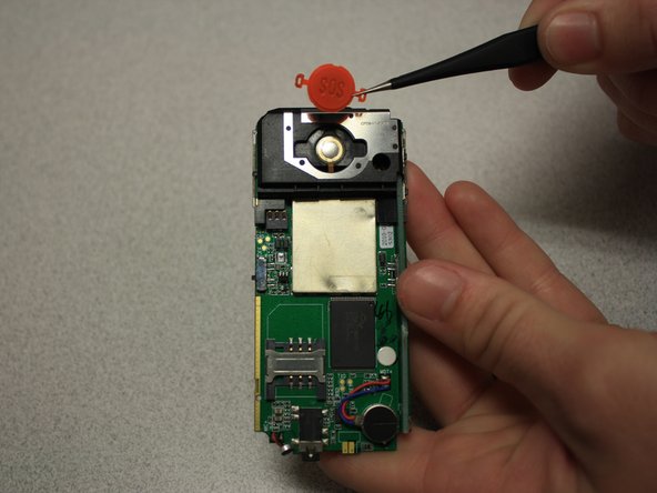

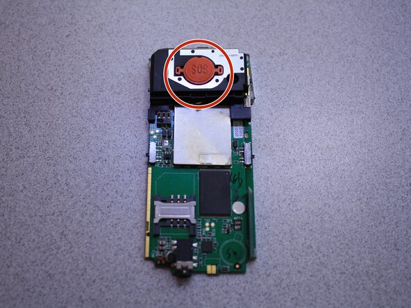

    1. Snapfon ezOne Speaker Replacement, Speaker: crwdns2935265:08crwdnd2935265:01crwdnd2935265:02crwdne2935265:0 Snapfon ezOne Speaker Replacement, Speaker: crwdns2935265:08crwdnd2935265:02crwdnd2935265:02crwdne2935265:0
      • Remove SOS button from circuit board with tweezers.

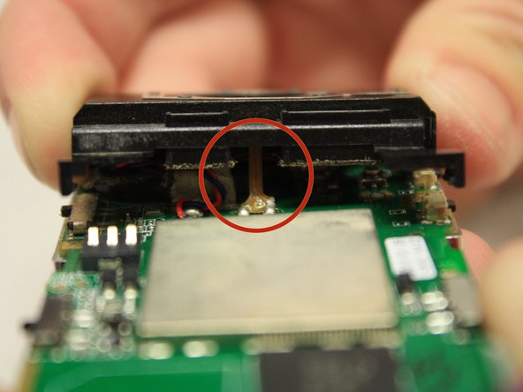

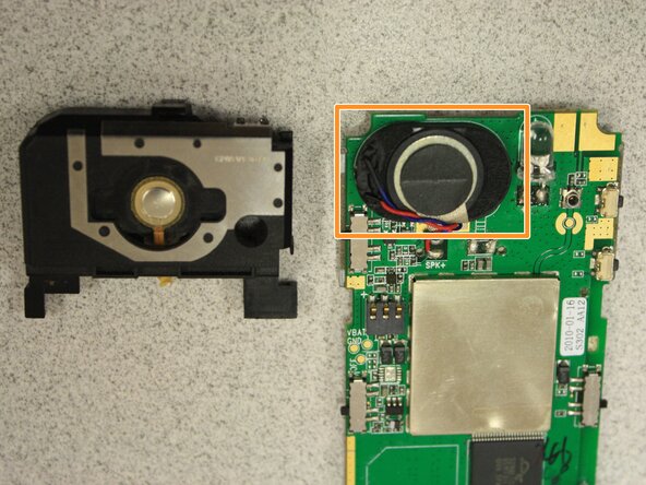

    2. Snapfon ezOne Speaker Replacement: crwdns2935265:09crwdnd2935265:01crwdnd2935265:03crwdne2935265:0 Snapfon ezOne Speaker Replacement: crwdns2935265:09crwdnd2935265:02crwdnd2935265:03crwdne2935265:0 Snapfon ezOne Speaker Replacement: crwdns2935265:09crwdnd2935265:03crwdnd2935265:03crwdne2935265:0
      • Pull black casing from the circuit board with fingers.
      • The black casing will not be able to be fully removed at this point
      • To fully remove the black casing, desolder the SOS button cable from the circuit board with a soldering iron.
      • The solder iron creates high temperatures that may cause bodily harm.
      • Once the black casing is removed, the speaker will now be exposed.

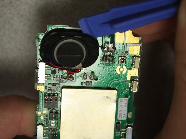

    3. Snapfon ezOne Speaker Replacement: crwdns2935265:010crwdnd2935265:01crwdnd2935265:03crwdne2935265:0 Snapfon ezOne Speaker Replacement: crwdns2935265:010crwdnd2935265:02crwdnd2935265:03crwdne2935265:0 Snapfon ezOne Speaker Replacement: crwdns2935265:010crwdnd2935265:03crwdnd2935265:03crwdne2935265:0

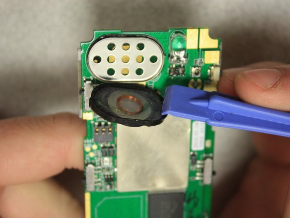

      • With the plastic opening tools, pry off the speaker from the circuit board.

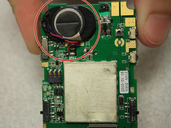

    4. Snapfon ezOne Speaker Replacement: crwdns2935265:011crwdnd2935265:01crwdnd2935265:02crwdne2935265:0 Snapfon ezOne Speaker Replacement: crwdns2935265:011crwdnd2935265:02crwdnd2935265:02crwdne2935265:0

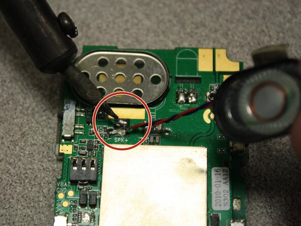

      • Desolder the speaker cables from the base of the circuit board with the soldering iron.
      • The soldering iron creates high temperatures that may cause bodily harm.
      • Melt the new speaker wires to the circuit board with the soldering iron.
