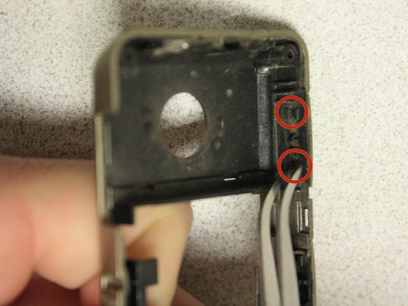

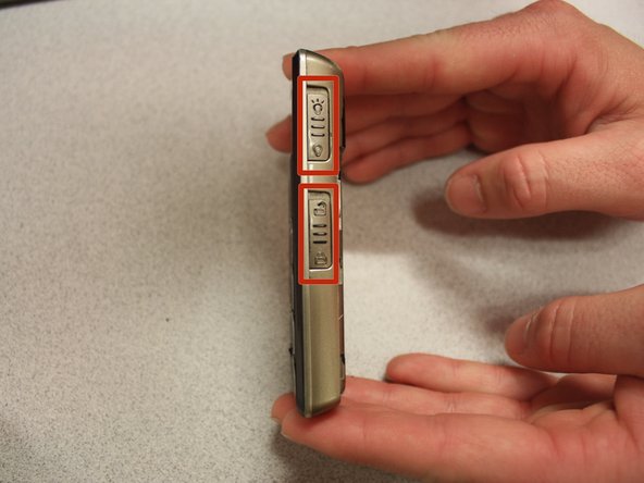

  8. Snapfon ez One Volume and Unlock switch replacement, Volume and Unlock switch: crwdns2935265:08crwdnd2935265:01crwdnd2935265:02crwdne2935265:0 Snapfon ez One Volume and Unlock switch replacement, Volume and Unlock switch: crwdns2935265:08crwdnd2935265:02crwdnd2935265:02crwdne2935265:0
    • All three of these switches (shown in the red boxes in these two pictures) are removed the same way. So this guide will show the removal and repair of only one switch.
    • The button (shown in blue) should already be removed from the disassembly of the circuit board portion of this guide.

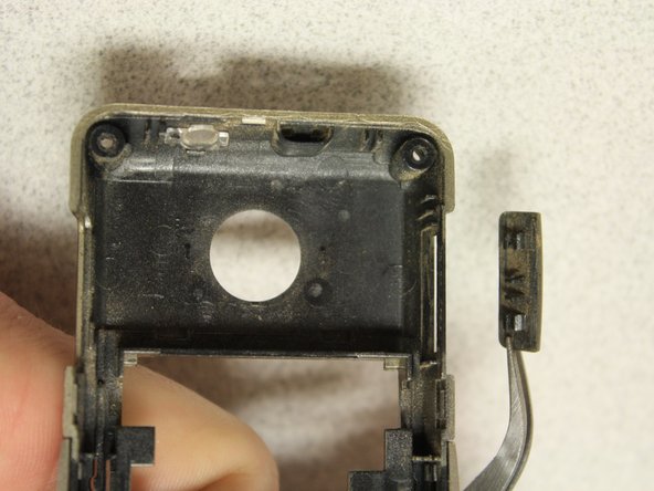

  9. Snapfon ez One Volume and Unlock switch replacement: crwdns2935265:09crwdnd2935265:01crwdnd2935265:03crwdne2935265:0 Snapfon ez One Volume and Unlock switch replacement: crwdns2935265:09crwdnd2935265:02crwdnd2935265:03crwdne2935265:0 Snapfon ez One Volume and Unlock switch replacement: crwdns2935265:09crwdnd2935265:03crwdnd2935265:03crwdne2935265:0
    • Use tweezers to pull the volume button out of the track.
    • Pinch the two sets of clamps together and push outwards (away from the phone) in order to remove the flashlight switch (or either of the other two switches).

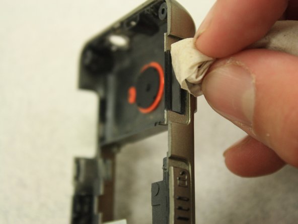

  10. Snapfon ez One Volume and Unlock switch replacement: crwdns2935265:010crwdnd2935265:01crwdnd2935265:03crwdne2935265:0 Snapfon ez One Volume and Unlock switch replacement: crwdns2935265:010crwdnd2935265:02crwdnd2935265:03crwdne2935265:0 Snapfon ez One Volume and Unlock switch replacement: crwdns2935265:010crwdnd2935265:03crwdnd2935265:03crwdne2935265:0

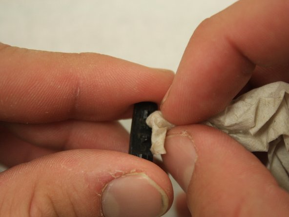

    • To remove stickiness or dirt, clean the switch with rubbing alcohol and a brush.
    • Let dry before putting the switch back on the phone.
    • Clean the port with a towel soaked in rubbing alcohol.
    • Finally, let both the port and switch dry before reassembling.
