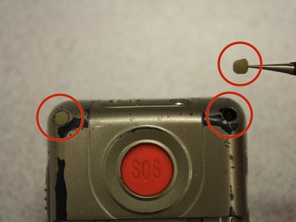

    1. Snapfon ez One Motherboard Replacement, Removing the plastic inserts: crwdns2935265:03crwdnd2935265:01crwdnd2935265:02crwdne2935265:0 Snapfon ez One Motherboard Replacement, Removing the plastic inserts: crwdns2935265:03crwdnd2935265:02crwdnd2935265:02crwdne2935265:0
      • Remove the four rubber inserts from the screw holes using a pair of tweezers.

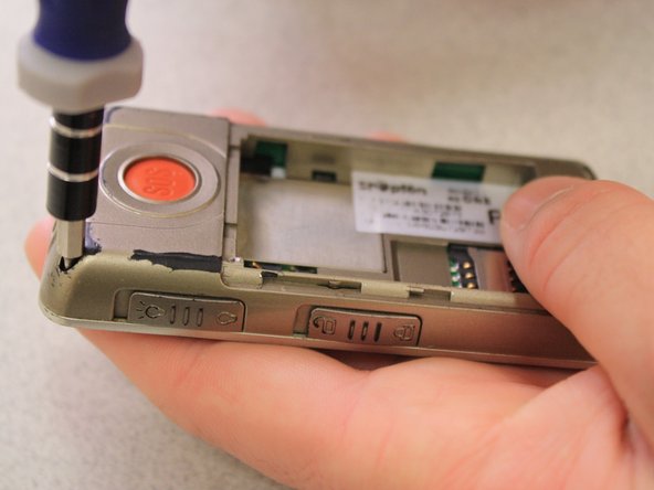

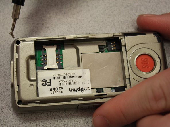

    2. Snapfon ez One Motherboard Replacement, Remove the shield screws: crwdns2935265:04crwdnd2935265:01crwdnd2935265:03crwdne2935265:0 Snapfon ez One Motherboard Replacement, Remove the shield screws: crwdns2935265:04crwdnd2935265:02crwdnd2935265:03crwdne2935265:0 Snapfon ez One Motherboard Replacement, Remove the shield screws: crwdns2935265:04crwdnd2935265:03crwdnd2935265:03crwdne2935265:0
      • Remove the four 3.1mm screws in the corners with a Phillips #00 screwdriver.

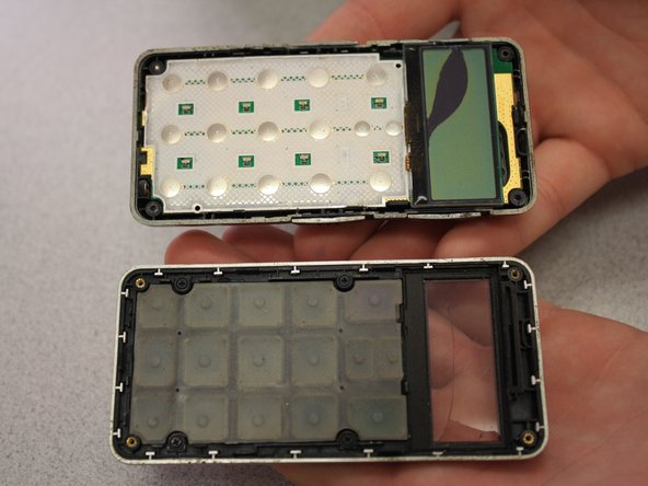

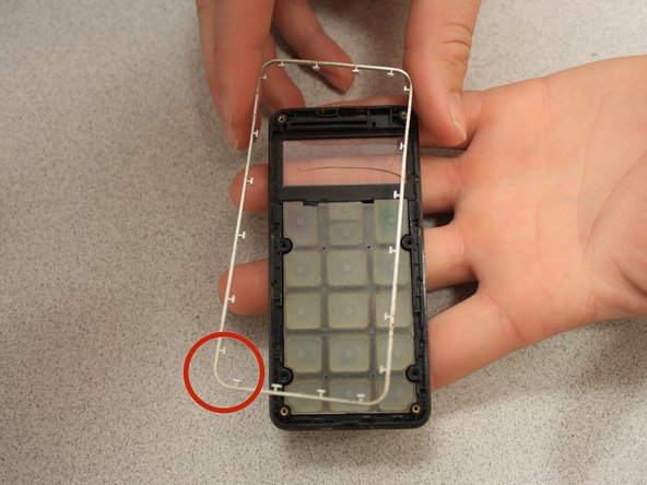

    3. Snapfon ez One Motherboard Replacement, Separate the case: crwdns2935265:05crwdnd2935265:01crwdnd2935265:03crwdne2935265:0 Snapfon ez One Motherboard Replacement, Separate the case: crwdns2935265:05crwdnd2935265:02crwdnd2935265:03crwdne2935265:0 Snapfon ez One Motherboard Replacement, Separate the case: crwdns2935265:05crwdnd2935265:03crwdnd2935265:03crwdne2935265:0
      • Separate the front case from the back case.
      • Remove the metal bumper from the front case’s perimeter.

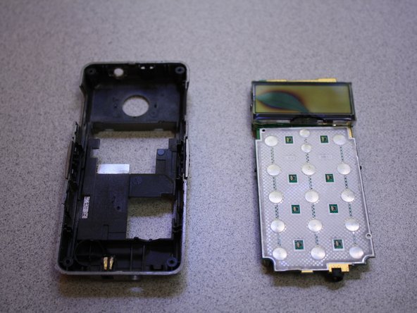

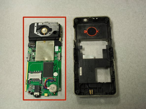

    5. Snapfon ez One Motherboard Replacement, Remove the motherboard: crwdns2935265:07crwdnd2935265:01crwdnd2935265:03crwdne2935265:0 Snapfon ez One Motherboard Replacement, Remove the motherboard: crwdns2935265:07crwdnd2935265:02crwdnd2935265:03crwdne2935265:0 Snapfon ez One Motherboard Replacement, Remove the motherboard: crwdns2935265:07crwdnd2935265:03crwdnd2935265:03crwdne2935265:0
      • Separate the circuit board from the inside of the back case by prying between them with the opening tool.
      • The last picture is a view of the back of the circuit board.
