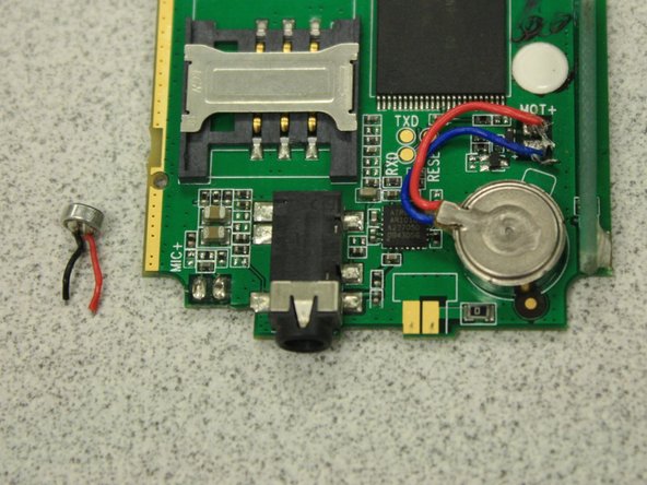

    1. Snapfon ez One Microphone Replacement, Microphone: crwdns2935265:08crwdnd2935265:01crwdnd2935265:01crwdne2935265:0
      • Locate the microphone on the back of the circuit board.
    2. Snapfon ez One Microphone Replacement: crwdns2935265:09crwdnd2935265:01crwdnd2935265:02crwdne2935265:0 Snapfon ez One Microphone Replacement: crwdns2935265:09crwdnd2935265:02crwdnd2935265:02crwdne2935265:0
      • Desolder the microphone from the circuit board using the soldering iron.
      • The solder iron creates high temperatures that may cause bodily harm.
      • Take the replacement microphone and melt the wires to the circuit board with the soldering iron in the same fashion that the old microphone was oriented.
