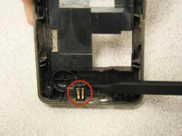

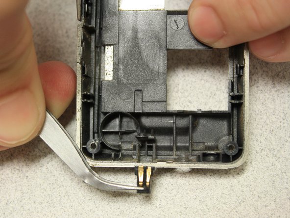

  8. Snapfon ez One Charging Port Replacement, Charging Port: crwdns2935265:08crwdnd2935265:01crwdnd2935265:03crwdne2935265:0 Snapfon ez One Charging Port Replacement, Charging Port: crwdns2935265:08crwdnd2935265:02crwdnd2935265:03crwdne2935265:0 Snapfon ez One Charging Port Replacement, Charging Port: crwdns2935265:08crwdnd2935265:03crwdnd2935265:03crwdne2935265:0
    • Use tweezers to remove the charging port located inside the back cover of the phone.
    • A spudger may be needed to apply pressure with the use of the tweezers for easier removal.
Insert new charging port, and to reassemble your device, follow these instructions in reverse order.
