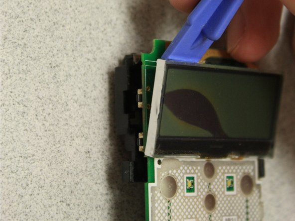

  8. Snapfōn ezONE LCD Screen Replacement, Pry the screen back: crwdns2935265:08crwdnd2935265:01crwdnd2935265:03crwdne2935265:0 Snapfōn ezONE LCD Screen Replacement, Pry the screen back: crwdns2935265:08crwdnd2935265:02crwdnd2935265:03crwdne2935265:0 Snapfōn ezONE LCD Screen Replacement, Pry the screen back: crwdns2935265:08crwdnd2935265:03crwdnd2935265:03crwdne2935265:0
    • Pry the LCD screen off of the circuit board using the opening tool. The screen is connected to the motherboard with light adhesive, which is easy to remove.
    • The LCD screen will still be connected to the circuit board by a ribbon cable.

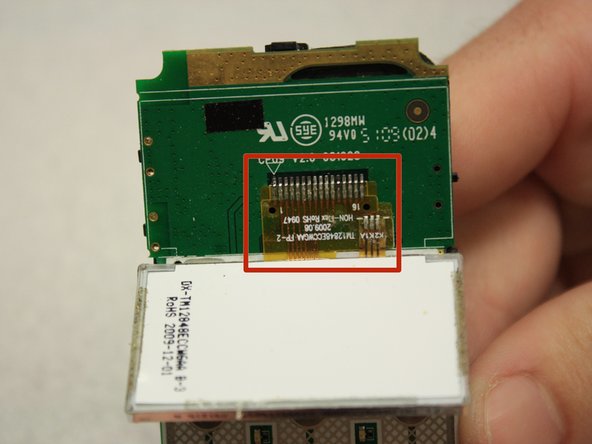

  9. Snapfōn ezONE LCD Screen Replacement, Disconnect the display: crwdns2935265:09crwdnd2935265:01crwdnd2935265:01crwdne2935265:0
    • Use a soldering iron to melt away the connection between the ribbon cable and circuit board.
    • Be careful! High temperatures from the soldering iron may result in injury.
    • Only make contact with the solder connection so that none of the phone’s components are damaged by the heat.
  10. Snapfōn ezONE LCD Screen Replacement, Remove the display: crwdns2935265:010crwdnd2935265:01crwdnd2935265:02crwdne2935265:0 Snapfōn ezONE LCD Screen Replacement, Remove the display: crwdns2935265:010crwdnd2935265:02crwdnd2935265:02crwdne2935265:0
    • Once you heat the solder connection, lightly tug the ribbon cable free. The LCD screen will be completely removed from the device.
