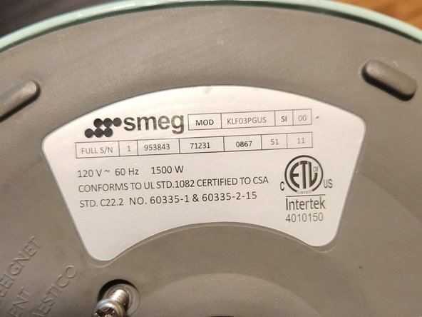

    • Remove 3 Philips screws at the bottom.
    • The plastic cover should come off easily. Pry softly on the side to wiggle it out with a pry pick

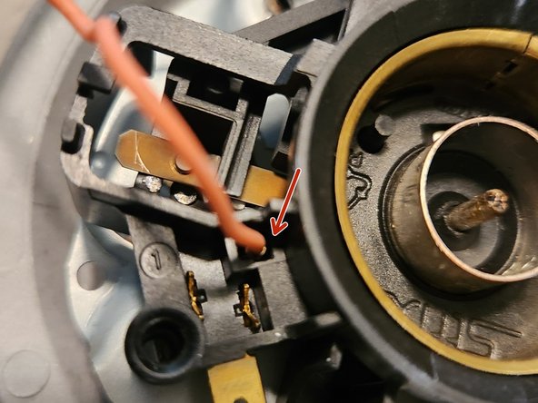

  2. Smeg Kettle temp control jug replacement, Disconnect the temp control Unit: crwdns2935265:02crwdnd2935265:01crwdnd2935265:02crwdne2935265:0 Smeg Kettle temp control jug replacement, Disconnect the temp control Unit: crwdns2935265:02crwdnd2935265:02crwdnd2935265:02crwdne2935265:0
    • Remove the 3 screws that that attached to the main body of the kettle (Red Circles)
    • Disconnect the heating element cables. They slide pretty easily without tools. (Green Arrows)

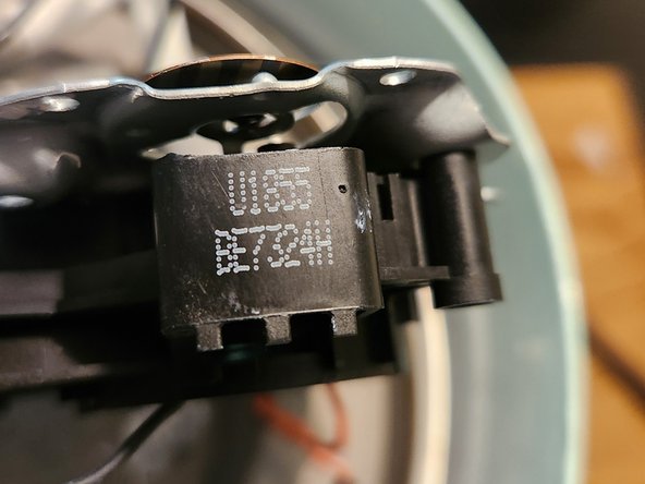

  3. Smeg Kettle temp control jug replacement, Disconnect switch and LED cables: crwdns2935265:03crwdnd2935265:01crwdnd2935265:03crwdne2935265:0 Smeg Kettle temp control jug replacement, Disconnect switch and LED cables: crwdns2935265:03crwdnd2935265:02crwdnd2935265:03crwdne2935265:0 Smeg Kettle temp control jug replacement, Disconnect switch and LED cables: crwdns2935265:03crwdnd2935265:03crwdnd2935265:03crwdne2935265:0
    • We need to disconnect the external switch mechanism from the temp sensor assembly. They are connected with a hinge (clear plastic to black plastic) in 4 points.(blue squares on image)
    • Carefully dissemble the clear plastic hinge from the temp sensor. Easy soft plastic to push away

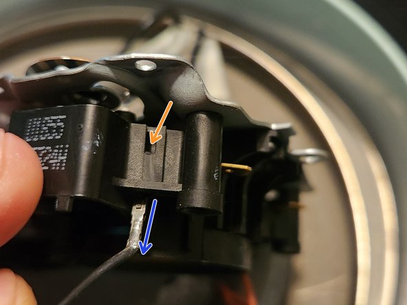

    • With thin tweezers or a toothpick disconnect RED and Black cables from the thermal sensor. They have thin connectors so be gentle to not snap them.
    • The black one has a side gap to push the spring connector out easier. Red does too, but it is but hidden and hard to press. Bend paper clip did the trick for me
