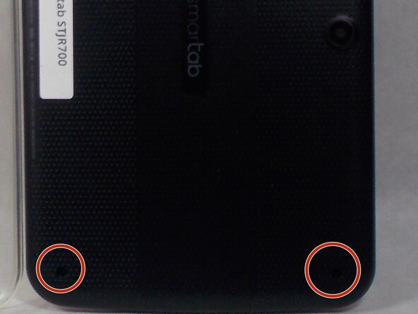

    • Power off device. Place it face down. Unscrew the 4 perimeter screws, using a PH000 screwdriver from iFixit kit

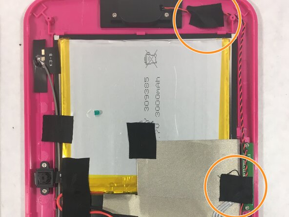

    • Using tweezers carefully remove tape that is holding the black and red intertwined cables to the motherboard. Place tape to the side as is will be needed for reassembly.

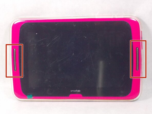

    • Remove the 2 screws holding the speaker to the front panel. Use a PH000 screwdriver from iFixit kit. Place the screws to the side as they will be needed for reassembly.
  5. Smartab STJR700 Speakers Replacement: crwdns2935265:05crwdnd2935265:01crwdnd2935265:01crwdne2935265:0
    • Use the metal spudger to remove the speaker from the front panel of the tablet.
