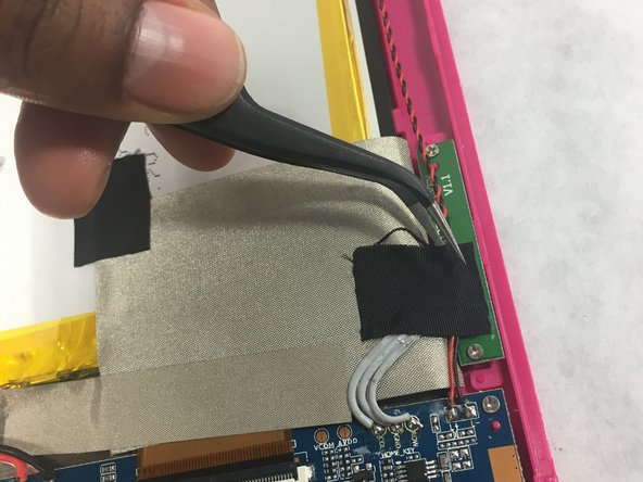

    • Using tweezers, carefully remove the tape that is holding the black and red intertwined cables to the motherboard. Place tape to the side as it will be needed for reassembly.

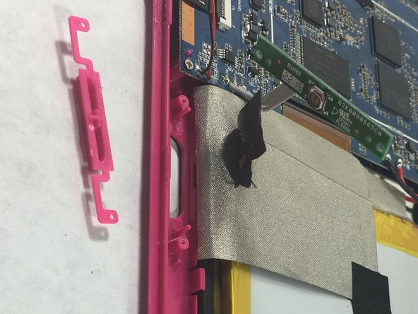

    • Remove the two Phillips #000 screws holding the home button board to the front panel.

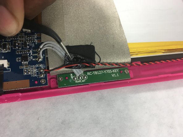

    • Using tweezers, slowly and carefully remove the end of the cable that connects the home button to the main motherboard.
