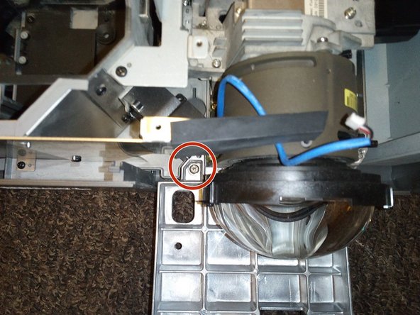

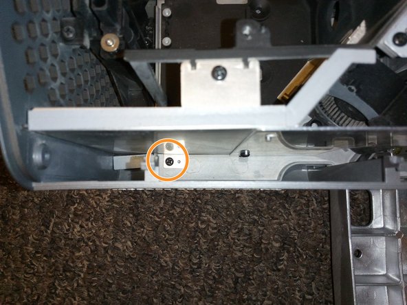

    • Remove this 7mm Philips #2 screw under the bulb cover.
    • Remove the 7mm Philips #2 screw deep in this hole. A magnetic screwdriver essential for removing and replacing this inaccessible screw.

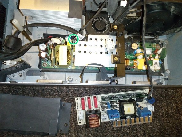

  4. Smart UF75 Mirror Replacement, Remove the metal cover: crwdns2935265:04crwdnd2935265:01crwdnd2935265:01crwdne2935265:0
    • Remove these 11 silver 5mm Philips #2 screws from the metal cover.
    • Unpeel this black card that is stuck to the metal cover.
    • Lift off the metal cover to reveal the main circuit board
  5. Smart UF75 Mirror Replacement, Unscrew the main circuit board: crwdns2935265:05crwdnd2935265:01crwdnd2935265:01crwdne2935265:0
    • Remove these 2 silver 8mm Philips #1 screws and their white plastic washers then unplug the ribbon cable. This plug will drop through the hole in the board when you lift off the board.
    • Remove these 6 silver 8mm Philips #2 screws from the main circuit board.
    • Remove these 2 silver 6mm Philips #2 screws that attach the board of plugs at the back of the projector.

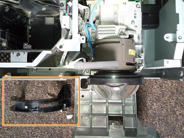

  12. Smart UF75 Mirror Replacement, unscrew the lens: crwdns2935265:012crwdnd2935265:01crwdnd2935265:02crwdne2935265:0 Smart UF75 Mirror Replacement, unscrew the lens: crwdns2935265:012crwdnd2935265:02crwdnd2935265:02crwdne2935265:0

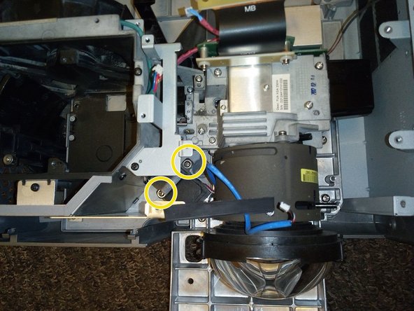

    • Remove the 4 silver 7mm Philips #2 screws that attach the lens unit to the mirror bracket.
  13. Smart UF75 Mirror Replacement, Remove the optical system: crwdns2935265:013crwdnd2935265:01crwdnd2935265:03crwdne2935265:0 Smart UF75 Mirror Replacement, Remove the optical system: crwdns2935265:013crwdnd2935265:02crwdnd2935265:03crwdne2935265:0 Smart UF75 Mirror Replacement, Remove the optical system: crwdns2935265:013crwdnd2935265:03crwdnd2935265:03crwdne2935265:0

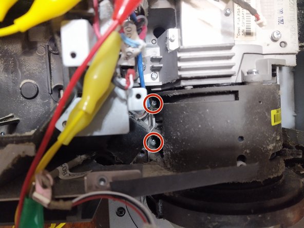

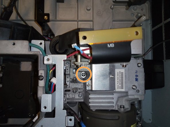

    • Remove these 3 silver 9mm Philips #2 screws holding down the main optical system.
    • Remove the fourth silver 9mm Philips #2 screw that is buried deep down the hole.

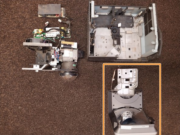

  14. Smart UF75 Mirror Replacement, Separate the parts: crwdns2935265:014crwdnd2935265:01crwdnd2935265:02crwdne2935265:0 Smart UF75 Mirror Replacement, Separate the parts: crwdns2935265:014crwdnd2935265:02crwdnd2935265:02crwdne2935265:0
    • The entire optical system can now be lifted out of the projector.
    • And the mirror bracket can now be lifted off the case
