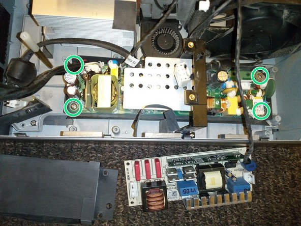

  9. Smart UF75 DMD chip Replacement, Move the power supplies: crwdns2935265:09crwdnd2935265:01crwdnd2935265:03crwdne2935265:0 Smart UF75 DMD chip Replacement, Move the power supplies: crwdns2935265:09crwdnd2935265:02crwdnd2935265:03crwdne2935265:0 Smart UF75 DMD chip Replacement, Move the power supplies: crwdns2935265:09crwdnd2935265:03crwdnd2935265:03crwdne2935265:0
    • Remove these 4 silver 6mm Philips #2 screws to release the top power supply.
    • Peel off this cardboard that is glued to the power supply cover.
    • Unplug the large plugs at each end of the power supply and move the power supply out of the way. You can leave the smaller fan wire connected.
    • Remove these 4 silver 8mm Philips #2 screws from the lower power supply then move the power unit to the side, along with the card it is resting on.

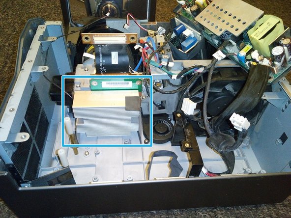

    • You now have clear access to the DMD heatsink.

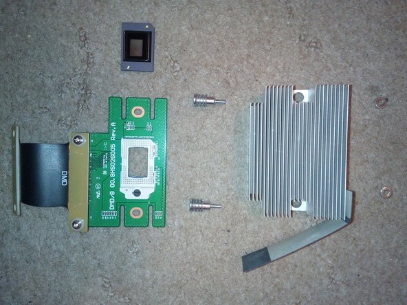

  10. Smart UF75 DMD chip Replacement, Remove the DMD module: crwdns2935265:010crwdnd2935265:01crwdnd2935265:03crwdne2935265:0 Smart UF75 DMD chip Replacement, Remove the DMD module: crwdns2935265:010crwdnd2935265:02crwdnd2935265:03crwdne2935265:0 Smart UF75 DMD chip Replacement, Remove the DMD module: crwdns2935265:010crwdnd2935265:03crwdnd2935265:03crwdne2935265:0
    • Before removing the DMD heatsink, clean any dust from the area to prevent dust getting into the optical system.

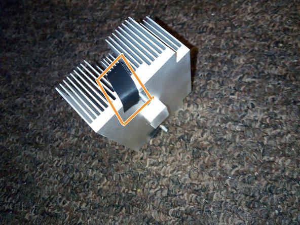

    • Remove these 2 Philips #2 screws holding the DMD heatsink. Two washers will drop down behind the heatsink when you remove these bolts. You will be able to retrieve these when you have removed the heatsink.
    • Peel back this sticky card to free the heatsink.
    • Pull back the heatsink then remove the DMD module

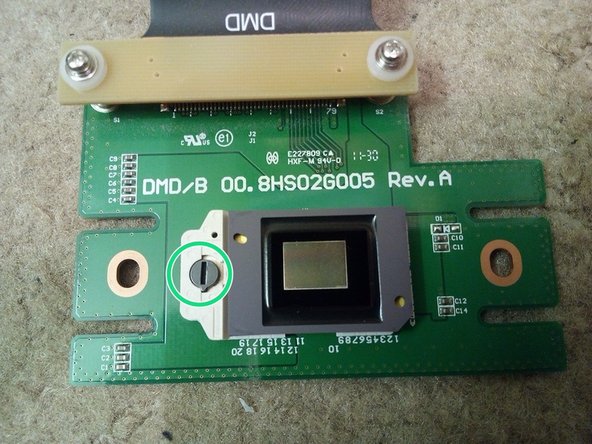

    • To remove the DMD chip, turn this screw half a turn anticlockwise.
    • Be careful not to get dust into the hole where the DMD module was. Those sensitive optical components should be protected from dust
    • Do not touch the surface of the DMD chip. The surface exposes 1024*768 tiny moving mirrors.

    • A poor thermal contact between the DMD chip and the heatsink could lead to premature failure of the chip. This projector uses thermal tape between the chip and the heatsink to ensure a good thermal contact.
    • Re-fitting the spacer washer that fits between the heatsink and the DMD board is tricky.
    • Use a thin strip of electrical tape to hold the washer and bolt in place while you re-assemble. The tape can be removed before tightening the bolts.
