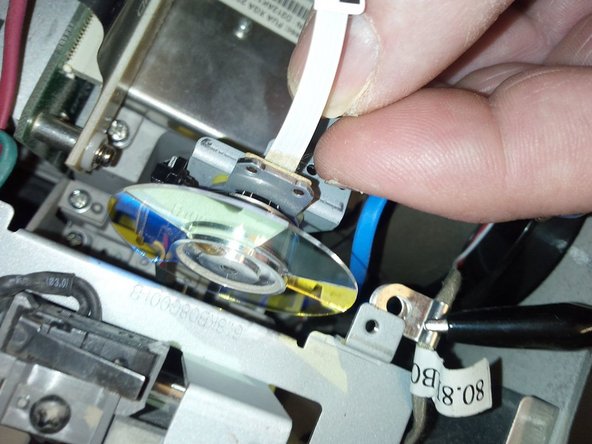

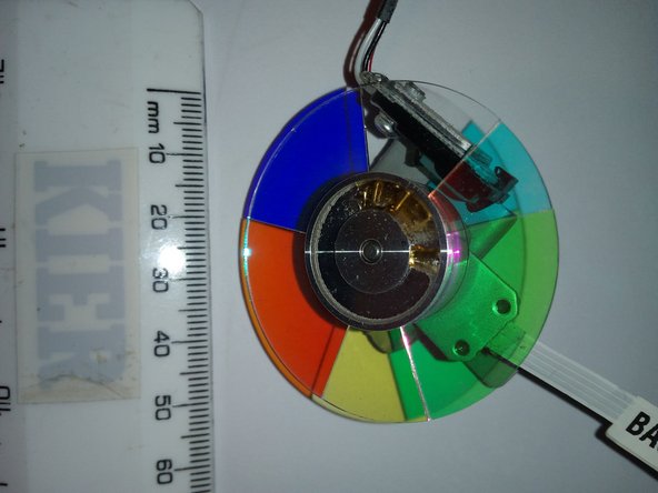

  9. Smart UF75 DLP Projector Disassembly, Remove the colour wheel: crwdns2935265:09crwdnd2935265:01crwdnd2935265:03crwdne2935265:0 Smart UF75 DLP Projector Disassembly, Remove the colour wheel: crwdns2935265:09crwdnd2935265:02crwdnd2935265:03crwdne2935265:0 Smart UF75 DLP Projector Disassembly, Remove the colour wheel: crwdns2935265:09crwdnd2935265:03crwdnd2935265:03crwdne2935265:0
    • To make a coloured image, the light shines through this spinning colour wheel then onto a Digital Micromirror Device (DMD) with 1024*768 small mirrors that move to switch each pixel on or off.
    • Remove these 2 silver 6mm Philips #1 screws to detach the colour wheel.
    • To remove the colour wheel you will need to cut a cable tie and move the wires to the side.
    • Then gently remove the delicate glass colour wheel.
    • Interesting Fact: the light at this point is in a narrow beam that passes through a hole 4mm * 5.3mm.

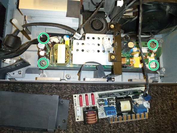

  10. Smart UF75 DLP Projector Disassembly, Remove the power supplies: crwdns2935265:010crwdnd2935265:01crwdnd2935265:02crwdne2935265:0 Smart UF75 DLP Projector Disassembly, Remove the power supplies: crwdns2935265:010crwdnd2935265:02crwdnd2935265:02crwdne2935265:0
    • Remove these 4 silver 6mm Philips #2 screws to release the top power supply.
    • Peel off this cardboard that is glued to the power supply cover.
    • Unplug the large plug at each end of the power supply and the smaller fan wire. You can now remove the top power supply.
    • Remove these 4 silver 8mm Philips #2 screws from the lower power supply and unplug the small wire. You can now remove the power supply and the card it is sitting on.

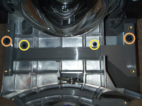

  11. Smart UF75 DLP Projector Disassembly, Remove the mirror cover plates: crwdns2935265:011crwdnd2935265:01crwdnd2935265:03crwdne2935265:0 Smart UF75 DLP Projector Disassembly, Remove the mirror cover plates: crwdns2935265:011crwdnd2935265:02crwdnd2935265:03crwdne2935265:0 Smart UF75 DLP Projector Disassembly, Remove the mirror cover plates: crwdns2935265:011crwdnd2935265:03crwdnd2935265:03crwdne2935265:0
    • This step is optional. You can dismantle the remainder of the projector without removing the mirror cover plates.
    • Remove these 6 black 5mm Philips #2 screws to release the two plastic covers on the front of the mirror area.
    • Remove these 2 black 5mm Philips #2 screws to release the plastic bar that supported the front cover.
    • Remove these 2 black 5mm Philips #2 screws to release the metal bar that attached the support for the front cover.
    • Remove these 2 black 5mm Philips #2 screws that are attaching the back mirror cover..

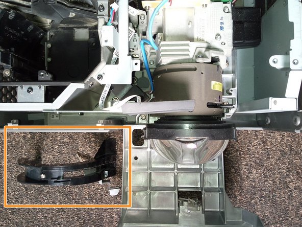

  12. Smart UF75 DLP Projector Disassembly, Remove the lens adjuster bracket: crwdns2935265:012crwdnd2935265:01crwdnd2935265:02crwdne2935265:0 Smart UF75 DLP Projector Disassembly, Remove the lens adjuster bracket: crwdns2935265:012crwdnd2935265:02crwdnd2935265:02crwdne2935265:0
    • Remove these 3 silver 8mm Philips #2 screws to release bracket that holds the lens adjuster knob.
    • And remove the bracket

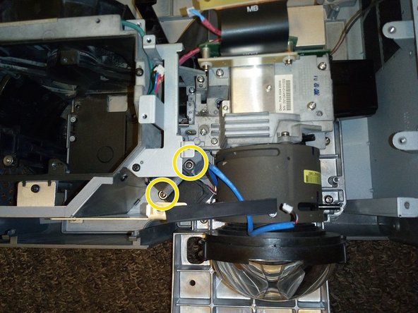

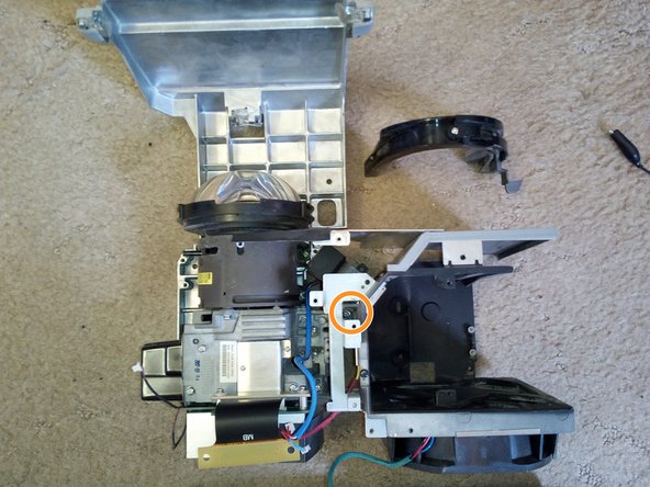

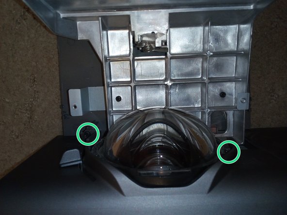

  13. Smart UF75 DLP Projector Disassembly, Unscrew the lamp housing: crwdns2935265:013crwdnd2935265:01crwdnd2935265:03crwdne2935265:0 Smart UF75 DLP Projector Disassembly, Unscrew the lamp housing: crwdns2935265:013crwdnd2935265:02crwdnd2935265:03crwdne2935265:0 Smart UF75 DLP Projector Disassembly, Unscrew the lamp housing: crwdns2935265:013crwdnd2935265:03crwdnd2935265:03crwdne2935265:0
    • Remove these 3 black 8mm Philips #2 screws holding down the lamp case.
    • And remove this fourth black 8mm Philips #2 screw holding down the front of the lamp housing.
    • Remove these 2 silver 6mm Philips #2 screws holding down the bulb fan.
  14. Smart UF75 DLP Projector Disassembly, Remove the optical system: crwdns2935265:014crwdnd2935265:01crwdnd2935265:03crwdne2935265:0 Smart UF75 DLP Projector Disassembly, Remove the optical system: crwdns2935265:014crwdnd2935265:02crwdnd2935265:03crwdne2935265:0 Smart UF75 DLP Projector Disassembly, Remove the optical system: crwdns2935265:014crwdnd2935265:03crwdnd2935265:03crwdne2935265:0
    • Remove these 4 silver 9mm Philips #2 screws holding down the main optical system.

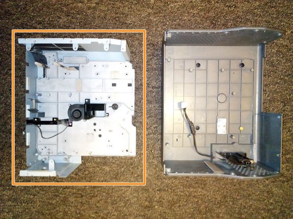

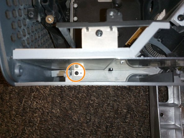

  15. Smart UF75 DLP Projector Disassembly, Separate the base from the case: crwdns2935265:015crwdnd2935265:01crwdnd2935265:02crwdne2935265:0 Smart UF75 DLP Projector Disassembly, Separate the base from the case: crwdns2935265:015crwdnd2935265:02crwdnd2935265:02crwdne2935265:0
    • If you want to separate the base chassis from the case, remove these 8 silver 8mm Philips #2 screws to separate the inner casing from the outer casing.
    • Then pull out the base chassis unit.

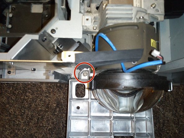

  16. Smart UF75 DLP Projector Disassembly, Separate the lamp housing: crwdns2935265:016crwdnd2935265:01crwdnd2935265:03crwdne2935265:0 Smart UF75 DLP Projector Disassembly, Separate the lamp housing: crwdns2935265:016crwdnd2935265:02crwdnd2935265:03crwdne2935265:0 Smart UF75 DLP Projector Disassembly, Separate the lamp housing: crwdns2935265:016crwdnd2935265:03crwdnd2935265:03crwdne2935265:0
    • Remove these 3 silver 8mm Philips #2 screws.
    • And remove this fourth screw buried deep down this hole. The fourth screw is easiest to see in the second picture.
    • You can now separate the lamp housing from the rest of the optical system.

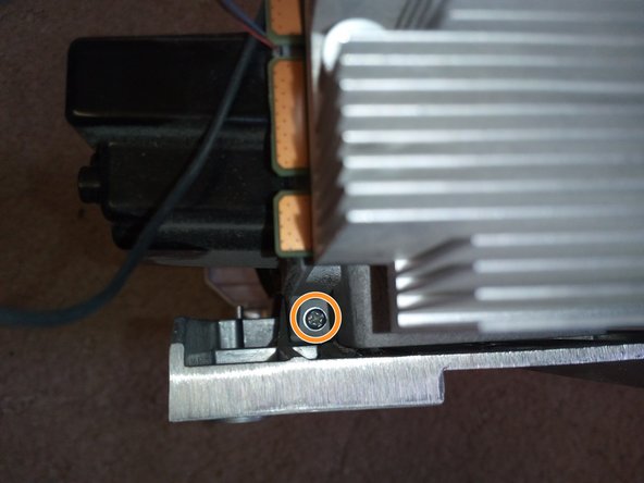

  17. Smart UF75 DLP Projector Disassembly, Separate the front lens section: crwdns2935265:017crwdnd2935265:01crwdnd2935265:03crwdne2935265:0 Smart UF75 DLP Projector Disassembly, Separate the front lens section: crwdns2935265:017crwdnd2935265:02crwdnd2935265:03crwdne2935265:0 Smart UF75 DLP Projector Disassembly, Separate the front lens section: crwdns2935265:017crwdnd2935265:03crwdnd2935265:03crwdne2935265:0
    • This step opens up the optical parts that were probably originally assembled in a clean room. Take care to minimise any dust of you need to separate the front lens section.
    • Remove 3 silver 12mm Philips #2 screws joining the DMD optical section to the front lens. The three screws cannot be seen in one picture, so three pictures are attached.
    • The top screw is visible as you look down on the unit.
    • The left hand screw is seen as you look along the left hand underside of the DMD heat sink
    • The right hand screw is visible as you look along the right hand underside of the DMD heat sink.

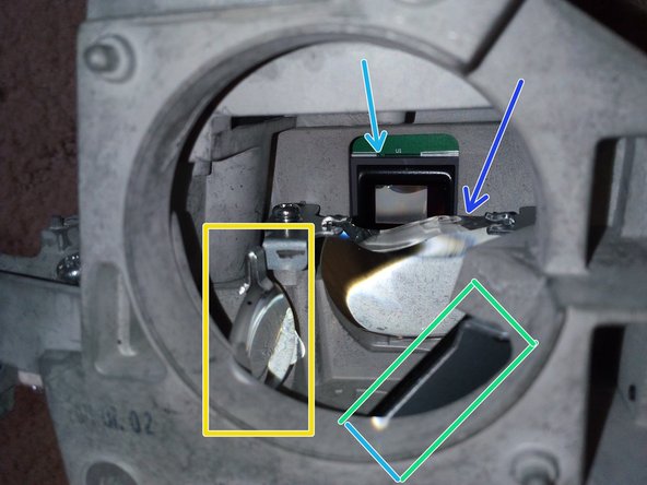

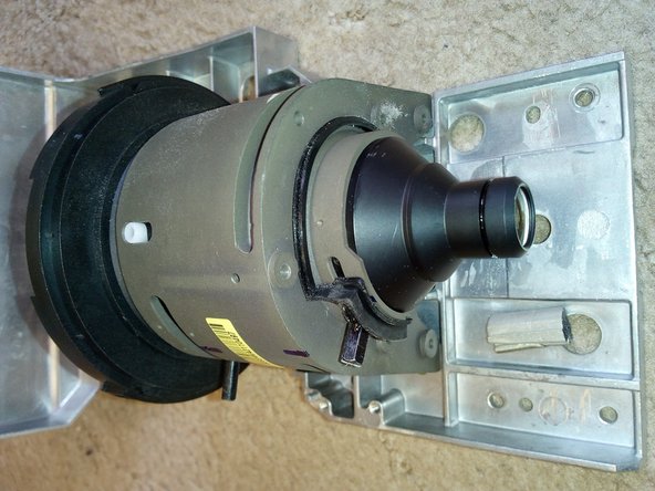

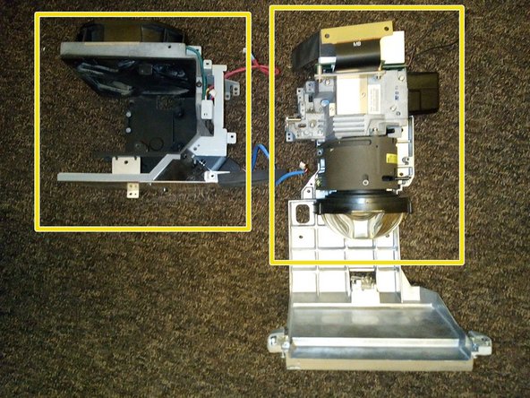

  18. Smart UF75 DLP Projector Disassembly, A look at the separated optical parts: crwdns2935265:018crwdnd2935265:01crwdnd2935265:03crwdne2935265:0 Smart UF75 DLP Projector Disassembly, A look at the separated optical parts: crwdns2935265:018crwdnd2935265:02crwdnd2935265:03crwdne2935265:0 Smart UF75 DLP Projector Disassembly, A look at the separated optical parts: crwdns2935265:018crwdnd2935265:03crwdnd2935265:03crwdne2935265:0
    • The first picture shows the front lens separated from the DMD optical section.
    • The second picture is a close up of the small lens at the back of the front lens section.
    • The third picture is a first look at the amazingly complicated DMD optical section. The next step takes a look inside this unit.

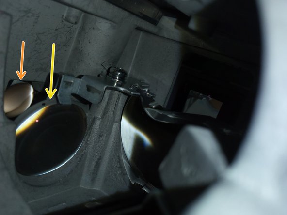

  19. Smart UF75 DLP Projector Disassembly, A look inside the DMD optical unit: crwdns2935265:019crwdnd2935265:01crwdnd2935265:03crwdne2935265:0 Smart UF75 DLP Projector Disassembly, A look inside the DMD optical unit: crwdns2935265:019crwdnd2935265:02crwdnd2935265:03crwdne2935265:0 Smart UF75 DLP Projector Disassembly, A look inside the DMD optical unit: crwdns2935265:019crwdnd2935265:03crwdnd2935265:03crwdne2935265:0
    • The light comes in from the colour wheel through a very small hole here.
    • It goes through a small lens here.
    • Then it goes through this lens
    • to get reflected off this mirror
    • and through this strange half lens onto the DMD chip at the back.
    • The DMD chip reflects selected pixels forwards to the front lens section.
    • The black box on the side is just another cooling fan.

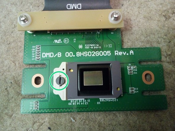

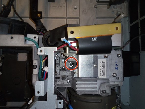

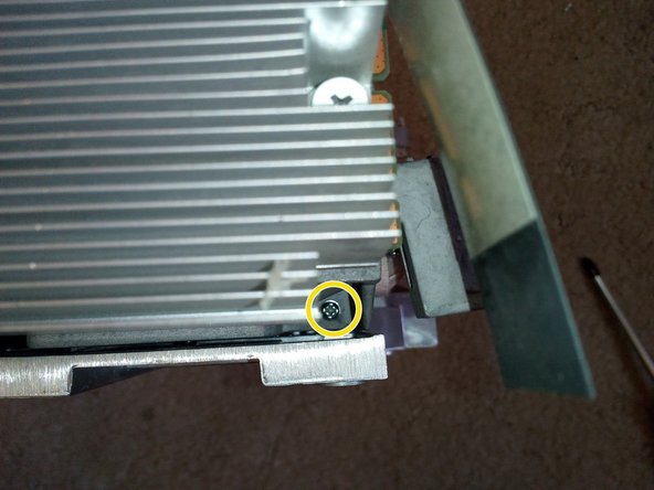

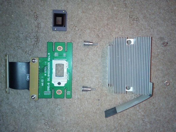

  20. Smart UF75 DLP Projector Disassembly, Remove the DMD chip: crwdns2935265:020crwdnd2935265:01crwdnd2935265:03crwdne2935265:0 Smart UF75 DLP Projector Disassembly, Remove the DMD chip: crwdns2935265:020crwdnd2935265:02crwdnd2935265:03crwdne2935265:0 Smart UF75 DLP Projector Disassembly, Remove the DMD chip: crwdns2935265:020crwdnd2935265:03crwdnd2935265:03crwdne2935265:0
    • Remove these 2 Philips #2 screws holding the DMD heatsink.
    • Pull back the heatsink then remove the DMD module
    • To remove the DMD chip, turn this screw half a turn anticlockwise.
