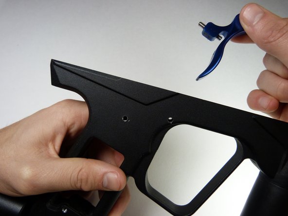

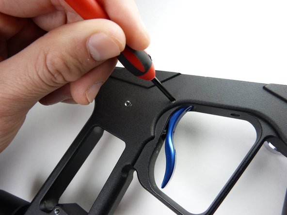

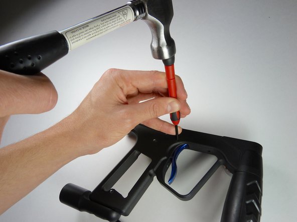

  12. Smart Parts Ion Trigger Replacement, Trigger: crwdns2935265:012crwdnd2935265:01crwdnd2935265:03crwdne2935265:0 Smart Parts Ion Trigger Replacement, Trigger: crwdns2935265:012crwdnd2935265:02crwdnd2935265:03crwdne2935265:0 Smart Parts Ion Trigger Replacement, Trigger: crwdns2935265:012crwdnd2935265:03crwdnd2935265:03crwdne2935265:0
    • Remove the trigger pin by tapping it out of the right side of the gun using a 3mm screwdriver.
    • Any small tool can be used for this step instead of a 3mm screwdriver
  13. Smart Parts Ion Trigger Replacement: crwdns2935265:013crwdnd2935265:01crwdnd2935265:02crwdne2935265:0 Smart Parts Ion Trigger Replacement: crwdns2935265:013crwdnd2935265:02crwdnd2935265:02crwdne2935265:0
    • Remove the trigger by pulling it out.
