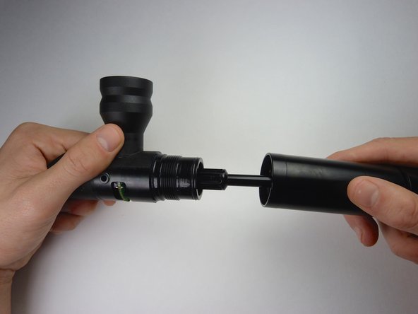

  16. Smart Parts Ion Bolt Replacement, Bolt: crwdns2935265:016crwdnd2935265:01crwdnd2935265:02crwdne2935265:0 Smart Parts Ion Bolt Replacement, Bolt: crwdns2935265:016crwdnd2935265:02crwdnd2935265:02crwdne2935265:0
    • Separate the front body breach from the fire chamber by rotating the breach counterclockwise.
  17. Smart Parts Ion Bolt Replacement: crwdns2935265:017crwdnd2935265:01crwdnd2935265:01crwdne2935265:0
    • Remove the bolt from the front body breach by gently pulling on the bolt.
