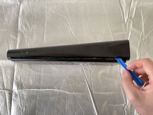

  3. Slingbox 500 Motherboard Replacement: crwdns2935265:03crwdnd2935265:01crwdnd2935265:03crwdne2935265:0 Slingbox 500 Motherboard Replacement: crwdns2935265:03crwdnd2935265:02crwdnd2935265:03crwdne2935265:0 Slingbox 500 Motherboard Replacement: crwdns2935265:03crwdnd2935265:03crwdnd2935265:03crwdne2935265:0
    • Remove the upper section of the case by rotating your Slingbox to view the back and lifting up on the higher corner.
    • Use the opening tool to disconnect the small clips in the front.
    • These may require some minor force to disconnect.
    • Remove the entire top of the Slingbox and set it aside.

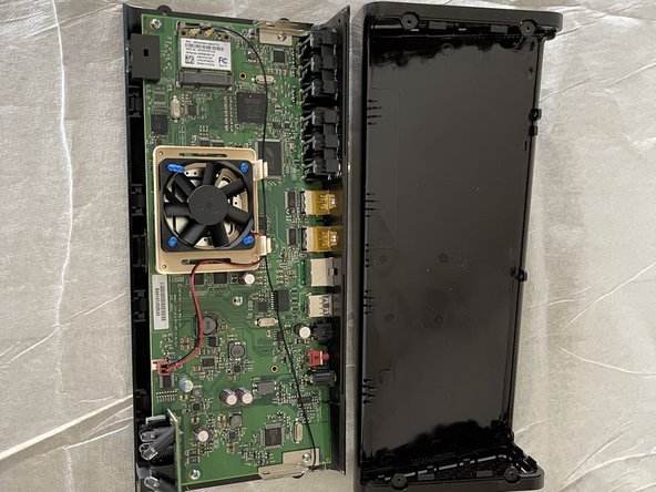

  4. Slingbox 500 Motherboard Replacement, Motherboard: crwdns2935265:04crwdnd2935265:01crwdnd2935265:02crwdne2935265:0 Slingbox 500 Motherboard Replacement, Motherboard: crwdns2935265:04crwdnd2935265:02crwdnd2935265:02crwdne2935265:0
    • Remove five 9.5 mm screws from the motherboard using a Phillips #1 screwdriver.
    • Push down firmly on the screws as to not strip them when removing them as they may not spin easily at first.
    • After removing the screws the two metal tabs on either side will be free. Make sure to not bend them or accidentally damage the wires while doing further dissasembly.
  5. Slingbox 500 Motherboard Replacement: crwdns2935265:05crwdnd2935265:01crwdnd2935265:01crwdne2935265:0
    • Remove the motherboard from the lower case.
