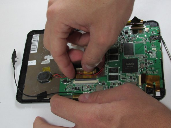

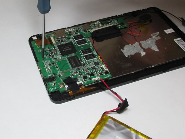

      • Follow the Case Replacement to separate the tablet from its backing
      • Using a small Phillips screw driver, unscrew all screws connecting circuit board to device
      • Remove all tape connecting battery and circuit board to front case
      • Detach all connector strips from the circuit board

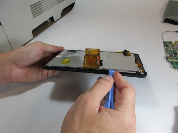

    2. Skytex SP728 Screen Replacement: crwdns2935265:06crwdnd2935265:01crwdnd2935265:02crwdne2935265:0 Skytex SP728 Screen Replacement: crwdns2935265:06crwdnd2935265:02crwdnd2935265:02crwdne2935265:0
      • Using the plastic opening tool, begin separating the front screen from the display
    3. Skytex SP728 Screen Replacement: crwdns2935265:07crwdnd2935265:01crwdnd2935265:01crwdne2935265:0
      • Once screen has been separated, use tweezers to remove front camera
