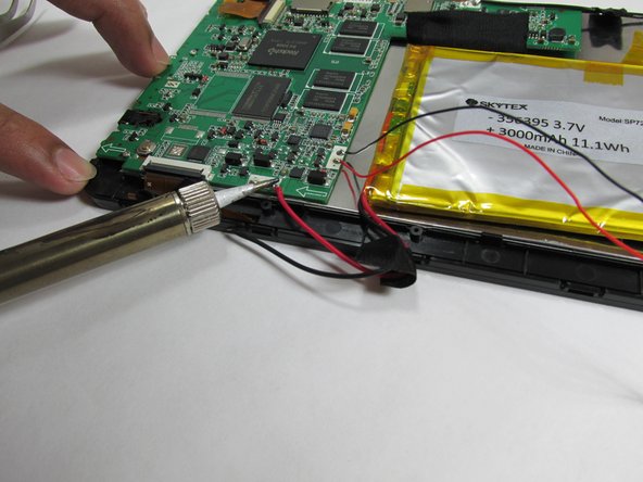

    1. Skytex SP728 Battery  Replacement, Battery: crwdns2935265:05crwdnd2935265:01crwdnd2935265:01crwdne2935265:0
      • Remove the yellow and black tape around the battery very carefully
    2. Skytex SP728 Battery  Replacement: crwdns2935265:06crwdnd2935265:01crwdnd2935265:02crwdne2935265:0 Skytex SP728 Battery  Replacement: crwdns2935265:06crwdnd2935265:02crwdnd2935265:02crwdne2935265:0
      • Use the soldering iron and remove soldered connections to separate the wires connected to the battery from the circuit board.
      • Follow the link below for additional soldering information How To Solder and Desolder Connections
      • Soldering uses heat so make sure you are careful while doing it. Also, excessive heat can damage the components. So do not apply the soldering iron on a component for extended periods of time.
    3. Skytex SP728 Battery  Replacement: crwdns2935265:07crwdnd2935265:01crwdnd2935265:01crwdne2935265:0
      • Using the plastic opening tool, lift up the battery from right edge and set aside.
      • Make sure that you take the battery out very carefully without bending it or damaging it as it contains toxic chemicals.
      • While soldering the wires for the new battery, remember that the red wire has to be connected to the positive terminal and the black wire has to be connected to the negative terminal.
To reassemble your device with a new battery, follow these instructions in reverse order.
