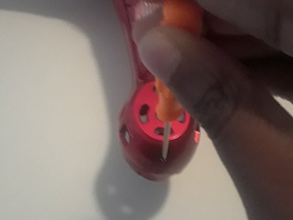

  2. Sky Thunder HD 8500WH Motor Replacement, Lockstitch: crwdns2935265:02crwdnd2935265:01crwdnd2935265:02crwdne2935265:0 Sky Thunder HD 8500WH Motor Replacement, Lockstitch: crwdns2935265:02crwdnd2935265:02crwdnd2935265:02crwdne2935265:0
    • Unscrew the 1cm screw holding in the blade lockstitch with the Phillips 0 Screwdriver.
    • Remove the blade lockstitch.

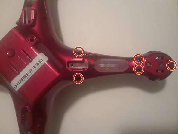

  3. Sky Thunder HD 8500WH Motor Replacement, Lower and Upper Body: crwdns2935265:03crwdnd2935265:01crwdnd2935265:03crwdne2935265:0 Sky Thunder HD 8500WH Motor Replacement, Lower and Upper Body: crwdns2935265:03crwdnd2935265:02crwdnd2935265:03crwdne2935265:0 Sky Thunder HD 8500WH Motor Replacement, Lower and Upper Body: crwdns2935265:03crwdnd2935265:03crwdnd2935265:03crwdne2935265:0
    • Lay down the drone so the battery side is facing up.
    • Unscrew all 5 .8cm screws on each arm of the drone with the Phillips 0 Screwdriver.
    • Repeat previous bullet for each arm (20 screws in total).

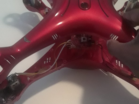

  4. Sky Thunder HD 8500WH Motor Replacement: crwdns2935265:04crwdnd2935265:01crwdnd2935265:02crwdne2935265:0 Sky Thunder HD 8500WH Motor Replacement: crwdns2935265:04crwdnd2935265:02crwdnd2935265:02crwdne2935265:0
    • Using a bit of force, gently pull apart the lower and upper bodies.
    • Keep going until both parts are completely separated.

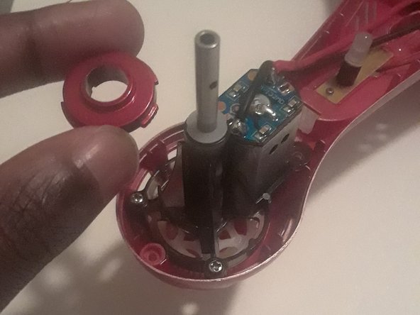

  5. Sky Thunder HD 8500WH Motor Replacement, Gear: crwdns2935265:05crwdnd2935265:01crwdnd2935265:02crwdne2935265:0 Sky Thunder HD 8500WH Motor Replacement, Gear: crwdns2935265:05crwdnd2935265:02crwdnd2935265:02crwdne2935265:0
    • Find the gear mechanism at the end of one of the drone arms.
    • Unscrew the two front .8cm screws with the Phillips 0 Screwdriver.
  6. Sky Thunder HD 8500WH Motor Replacement: crwdns2935265:06crwdnd2935265:01crwdnd2935265:02crwdne2935265:0 Sky Thunder HD 8500WH Motor Replacement: crwdns2935265:06crwdnd2935265:02crwdnd2935265:02crwdne2935265:0
    • Remove the white spacer.
    • Remove the red spacer.
  7. Sky Thunder HD 8500WH Motor Replacement: crwdns2935265:07crwdnd2935265:01crwdnd2935265:01crwdne2935265:0
    • Pull the gear out from the bottom of the holding mechanism.
  8. Sky Thunder HD 8500WH Motor Replacement, Motor: crwdns2935265:08crwdnd2935265:01crwdnd2935265:02crwdne2935265:0 Sky Thunder HD 8500WH Motor Replacement, Motor: crwdns2935265:08crwdnd2935265:02crwdnd2935265:02crwdne2935265:0
    • Unscrew the two .8cm screws on the bottom of the holding mechanism with the Phillips 0 Screwdriver.
    • Remove the motor from the holding mechanism.
