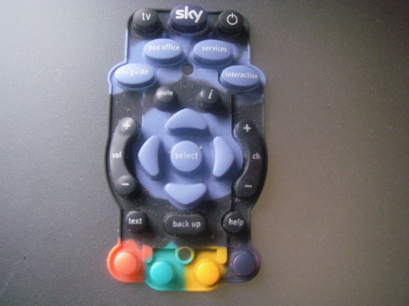

  3. Sky TV Remote Teardown: crwdns2935265:03crwdnd2935265:01crwdnd2935265:03crwdne2935265:0 Sky TV Remote Teardown: crwdns2935265:03crwdnd2935265:02crwdnd2935265:03crwdne2935265:0 Sky TV Remote Teardown: crwdns2935265:03crwdnd2935265:03crwdnd2935265:03crwdne2935265:0
    • After all the tabs are off, the body should just fall away leaving the buttons, the circuit board, the case and the black infra-red bit at the end.
    • Ta-daa!
