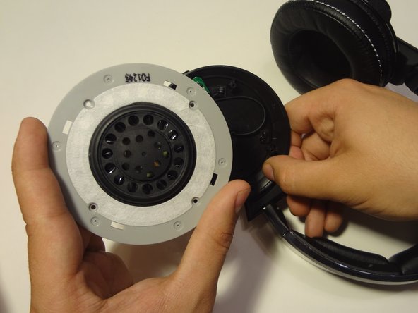

    • With the plastic opening tool, separate the padded ear cup from the main speaker component.
    • Make sure to fold the ear cup inward to avoid getting in the way of the opposite side.
  2. Skullcandy Mix Master DJ Mylar Driver Replacement: crwdns2935265:02crwdnd2935265:01crwdnd2935265:01crwdne2935265:0
    • Using your screw driver, remove the six Philips 2mm screws located on the chrome ring.

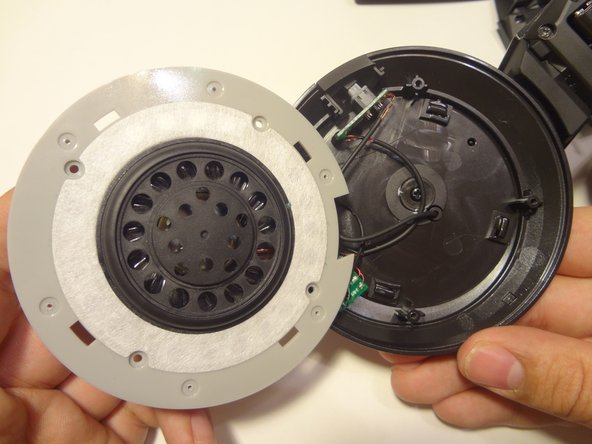

  3. Skullcandy Mix Master DJ Mylar Driver Replacement: crwdns2935265:03crwdnd2935265:01crwdnd2935265:02crwdne2935265:0 Skullcandy Mix Master DJ Mylar Driver Replacement: crwdns2935265:03crwdnd2935265:02crwdnd2935265:02crwdne2935265:0
    • Using your screw driver, remove the four 3mm Phillips screws located on the grey speaker.
    • Remove the driver from the gray speaker assembly.
    • Carefully remove the driver assembly since there are wires connected to the headphone jack, headband, and mute button.

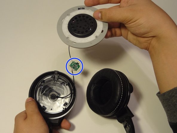

  4. Skullcandy Mix Master DJ Mylar Driver Replacement: crwdns2935265:04crwdnd2935265:01crwdnd2935265:02crwdne2935265:0 Skullcandy Mix Master DJ Mylar Driver Replacement: crwdns2935265:04crwdnd2935265:02crwdnd2935265:02crwdne2935265:0
    • Using your screw driver, remove the two 2mm Phillips screws located on the circuit panel of the audio jack.
    • Carefully separate the jack from the ear cup casing.
    • If you are working on the right ear cup, the mute button circuit board may be difficult to remove.
  5. Skullcandy Mix Master DJ Mylar Driver Replacement: crwdns2935265:05crwdnd2935265:01crwdnd2935265:02crwdne2935265:0 Skullcandy Mix Master DJ Mylar Driver Replacement: crwdns2935265:05crwdnd2935265:02crwdnd2935265:02crwdne2935265:0
    • The Mylar driver is connected to several small circuit boards by soldered wires. It can only be removed by cutting the connecting wires.
    • Do not pull the driver away too fast since there are wires connecting the driver to the ear cup.
