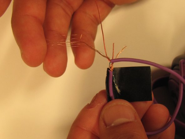

      • If your wire is severed, the first step is removing the rubber coating to expose both ends of the severed wire.
      • Do this by wedging it in a sharp crevice and pulling at the rubber coating. It should strip just the rubber coating. The small wedge in a spudger should suffice.
    2. Skullcandy Lowrider Wiring Repair: crwdns2935265:02crwdnd2935265:01crwdnd2935265:02crwdne2935265:0 Skullcandy Lowrider Wiring Repair: crwdns2935265:02crwdnd2935265:02crwdnd2935265:02crwdne2935265:0
      • Now that the internal wires have been exposed, take one end and group all similarly colored wires together.
      • Do the same for the other severed wire.

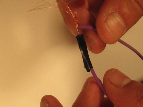

    3. Skullcandy Lowrider Wiring Repair: crwdns2935265:03crwdnd2935265:01crwdnd2935265:03crwdne2935265:0 Skullcandy Lowrider Wiring Repair: crwdns2935265:03crwdnd2935265:02crwdnd2935265:03crwdne2935265:0 Skullcandy Lowrider Wiring Repair: crwdns2935265:03crwdnd2935265:03crwdnd2935265:03crwdne2935265:0
      • Twist the green wires from both ends of the severed wire together.
      • Cover in electrical tape.
    4. Skullcandy Lowrider Wiring Repair: crwdns2935265:04crwdnd2935265:01crwdnd2935265:01crwdne2935265:0
      • Do the same for all matching wires on both ends.
      • Cover completely in electrical tape.
