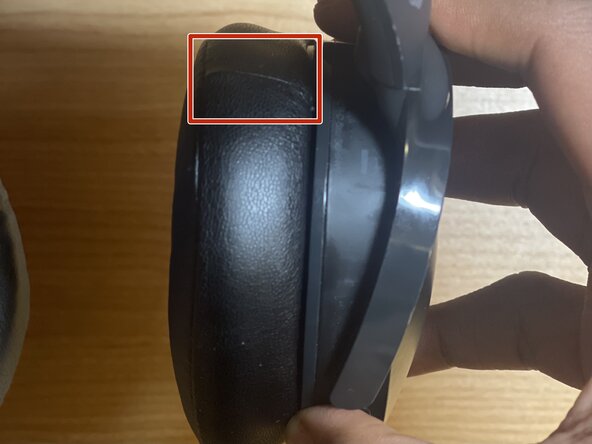

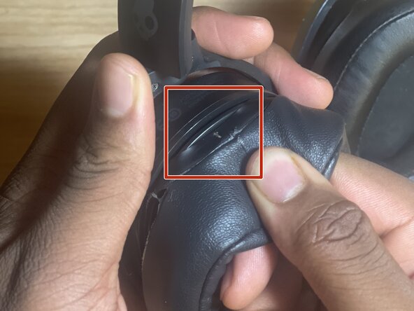

    • Locate the seam at the top or bottom of the ear pad.
  2. Skullcandy Hesh ANC Earpad Replacement: crwdns2935265:02crwdnd2935265:01crwdnd2935265:03crwdne2935265:0 Skullcandy Hesh ANC Earpad Replacement: crwdns2935265:02crwdnd2935265:02crwdnd2935265:03crwdne2935265:0 Skullcandy Hesh ANC Earpad Replacement: crwdns2935265:02crwdnd2935265:03crwdnd2935265:03crwdne2935265:0

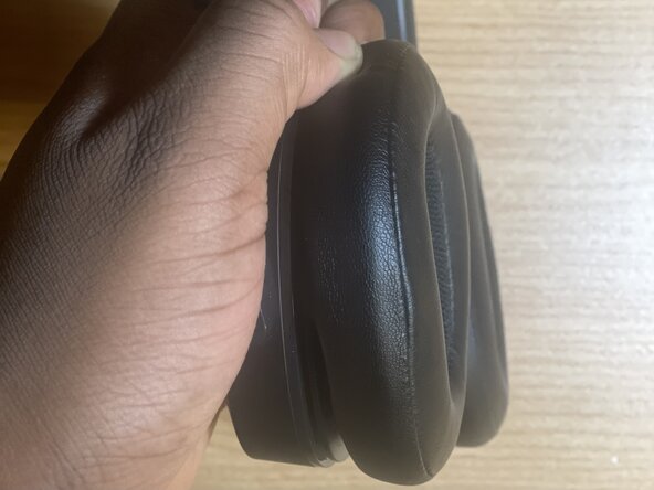

    • Pull the damaged earpad gently, starting from the seam located in Step 1.
    • Pull until you can see the seam of the earpad start to come off the headphones.
    • Make sure to get rid of any excess material left after completely removing the damaged earpad.

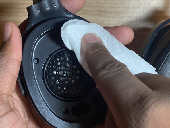

  3. Skullcandy Hesh ANC Earpad Replacement: crwdns2935265:03crwdnd2935265:01crwdnd2935265:03crwdne2935265:0 Skullcandy Hesh ANC Earpad Replacement: crwdns2935265:03crwdnd2935265:02crwdnd2935265:03crwdne2935265:0 Skullcandy Hesh ANC Earpad Replacement: crwdns2935265:03crwdnd2935265:03crwdnd2935265:03crwdne2935265:0

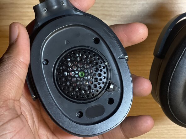

    • Once the ear pad is completely removed, softly clean the surface of the exposed headphone speakers and the area surrounding it with a clean cloth.
    • Potential for device damage: Be sure to use a dry cloth and not a wet one to prevent any damage to the interior of the headphones.

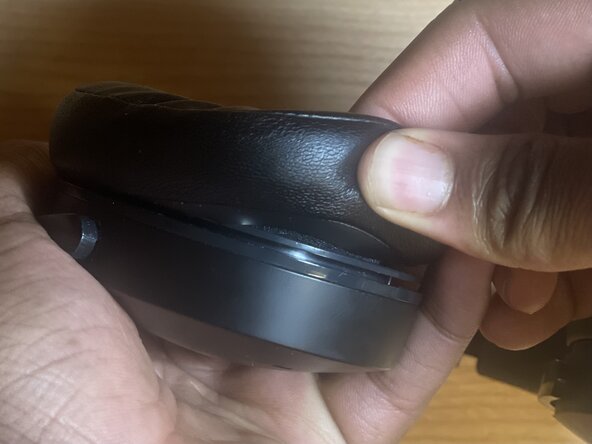

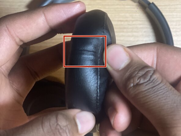

    • Grab your replacement earpads and again, locate the seam.
  5. Skullcandy Hesh ANC Earpad Replacement: crwdns2935265:05crwdnd2935265:01crwdnd2935265:03crwdne2935265:0 Skullcandy Hesh ANC Earpad Replacement: crwdns2935265:05crwdnd2935265:02crwdnd2935265:03crwdne2935265:0 Skullcandy Hesh ANC Earpad Replacement: crwdns2935265:05crwdnd2935265:03crwdnd2935265:03crwdne2935265:0

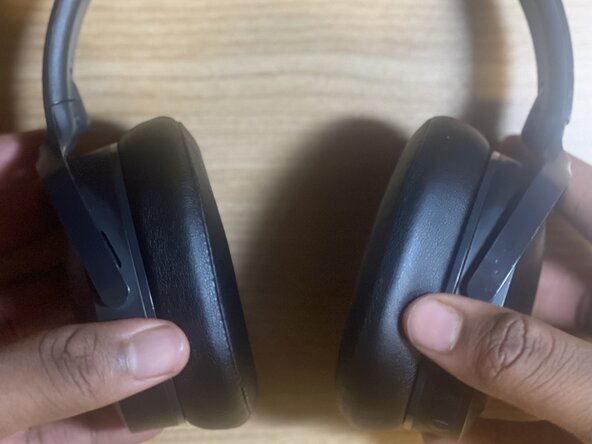

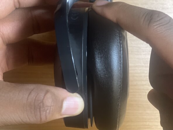

    • Starting from the top of the headphones, slowly and gently align the seam of the earpad into the slot allocated for it.
    • Use a finger to keep the replacement earpad in place once inserted.

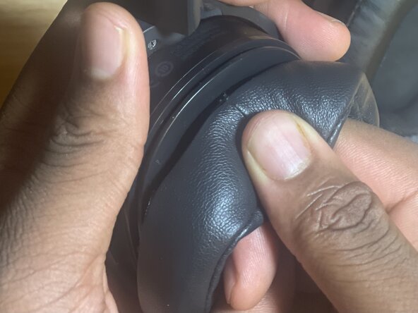

  6. Skullcandy Hesh ANC Earpad Replacement: crwdns2935265:06crwdnd2935265:01crwdnd2935265:03crwdne2935265:0 Skullcandy Hesh ANC Earpad Replacement: crwdns2935265:06crwdnd2935265:02crwdnd2935265:03crwdne2935265:0 Skullcandy Hesh ANC Earpad Replacement: crwdns2935265:06crwdnd2935265:03crwdnd2935265:03crwdne2935265:0

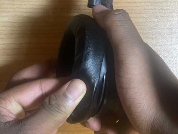

    • With the top held in place, slowly work your way around the earpad, aligning it around the headphone until the seam isn't visible anymore and the earpad is firmly in place.
    • Use your fingers to softly press around the edges of the earpad to ensure it has been completely attached.
