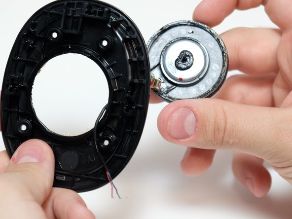

  3. Skullcandy Hesh 3 Speaker Replacement: crwdns2935265:03crwdnd2935265:01crwdnd2935265:03crwdne2935265:0 Skullcandy Hesh 3 Speaker Replacement: crwdns2935265:03crwdnd2935265:02crwdnd2935265:03crwdne2935265:0 Skullcandy Hesh 3 Speaker Replacement: crwdns2935265:03crwdnd2935265:03crwdnd2935265:03crwdne2935265:0
    • Position the speaker so the inside is facing up.
    • Use a heat gun to warm the adhesive securing the speaker to the housing.
    • Aim the gun from a distance to prevent any damage to the plastic. Always keep the heat gun in motion while using it so one area doesn't melt.
    • Use tweezers to push the speaker through to remove it. Avoid using your hands directly on the speaker to avoid burns.
