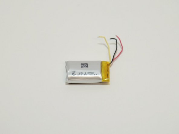

    3. Skullcandy Hesh 3 Battery Replacement: crwdns2935265:03crwdnd2935265:01crwdnd2935265:03crwdne2935265:0 Skullcandy Hesh 3 Battery Replacement: crwdns2935265:03crwdnd2935265:02crwdnd2935265:03crwdne2935265:0 Skullcandy Hesh 3 Battery Replacement: crwdns2935265:03crwdnd2935265:03crwdnd2935265:03crwdne2935265:0
      • Remove the battery being held by adhesive rubber with a spudger or your hands.
      • The battery should come out with minimal force as the adhesive is not very strong.
      • When replacing with the new battery, position it in the same spot with the 3 wires sticking out from the upper left-hand corner.
