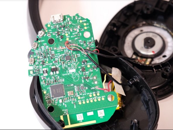

    • Use a soldering iron to heat up the solder at the points where the red, yellow, and black battery cables connect until they detach from the board.
    • Detach the connector on the side of the headphone cup to disconnect the red and black cables (next to the battery cables) from the headphones.
    • Slide the motherboard out of the headphone cup and flip it over.
    • Careful that you don't rip any of the remaining soldered connections (like the speaker connections for example.)
  3. Skullcandy Hesh 3 Auxiliary Port Replacement: crwdns2935265:03crwdnd2935265:01crwdnd2935265:02crwdne2935265:0 Skullcandy Hesh 3 Auxiliary Port Replacement: crwdns2935265:03crwdnd2935265:02crwdnd2935265:02crwdne2935265:0
    • Use tweezers to hold the aux port in place, and use a soldering iron to desolder the aux port points.
    • Use tweezers to remove the aux port.
    • Before attaching the new aux port, make sure to clean the previous spot, and remove any residue of adhesive using a connector conditioner and detailing brush.
