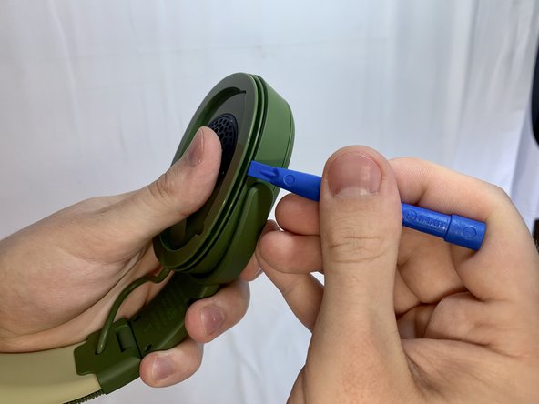

    2. Skullcandy Crusher Wireless Battery Replacement: crwdns2935265:05crwdnd2935265:01crwdnd2935265:03crwdne2935265:0 Skullcandy Crusher Wireless Battery Replacement: crwdns2935265:05crwdnd2935265:02crwdnd2935265:03crwdne2935265:0 Skullcandy Crusher Wireless Battery Replacement: crwdns2935265:05crwdnd2935265:03crwdnd2935265:03crwdne2935265:0
      • Slide a plastic opening tool between the plastic frame and speaker assembly of the headphones.
      • Gently pry the speaker part away from the frame of the headphones.
    3. Skullcandy Crusher Wireless Battery Replacement: crwdns2935265:06crwdnd2935265:01crwdnd2935265:02crwdne2935265:0 Skullcandy Crusher Wireless Battery Replacement: crwdns2935265:06crwdnd2935265:02crwdnd2935265:02crwdne2935265:0
      • Separate the headphone speaker assembly from the headphone speaker frame.
